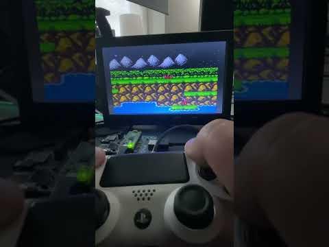

Posted: 01:17pm 08 Feb 2025
@Amnesie & All,
NES firmware of the pico-infoNESplus project for the PicoMiteHDMI scheme has been updated - stability in operation and the number of supported joysticks have been added.
picoNES+_PicoMiteHDMI.zip
Gamepad and keyboard usage
Menu Usage
Gamepad buttons:
UP/DOWN: Next/previous item in the menu.
LEFT/RIGHT: next/previous page.
A (Circle): Open folder/flash and start game.
B (X): Back to parent folder.
START: Starts game currently loaded in flash.
The colors in the menu can be changed and saved:
Select + Up/Down changes the foreground color.
Select + Left/Right changes the background color.
Select + A saves the colors. Screen will flicker when saved.
Select + B resets the colors to default. (Black on white)
When using an USB-Keyboard:
Cursor keys: Up, Down, left, right
Z: Back to parent folder
X: Open Folder/flash and start a game
S: Starts game currently loaded in flash.
A: acts as the select button.
Emulator (in game)
Gamepad buttons:
SELECT + START, Xbox button: Resets back to the SD Card menu. Game saves are saved to the SD card.
SELECT + UP/SELECT + DOWN: switches screen modes.
SELECT + A/B: toggle rapid-fire.
START + A : Toggle framerate display
When using a Genesis Mini controller, press C for SELECT.
Cursor keys: up, down, left, right
A: Select
S: Start
Z: B
X: A
