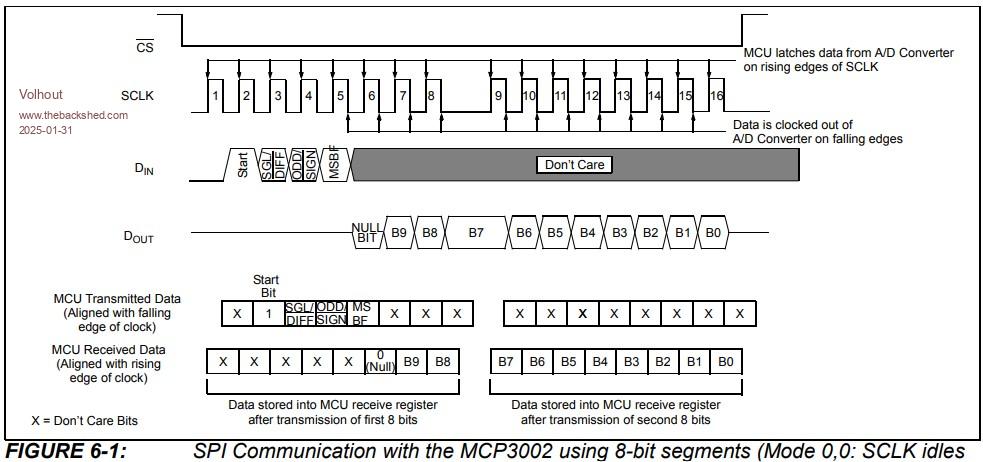

So summary:
- do not use a clock higher that 1MHz (the chip does 2 MHz max at 3.3V)
- use 16 bit transfers (or 2x8 bit transfers as below)
- you need to mask the read ADC value, since the MSB's are determined by pullup or pulldown.
- you need to use SPI mode 0 (called "0.0" in the datasheet). in essence this chip understands SPI mode 0 and 3, but not 1 and 2.
- you need to receive data while sending. use the function
value = SPI2( data )
 Do not use commands SPI WRITE and SPI READ, since these do not operate at the same time.
as TassyJim said: SPI2 OPEN 1000000,0,16
Edited 2025-01-31 18:24 by Volhout

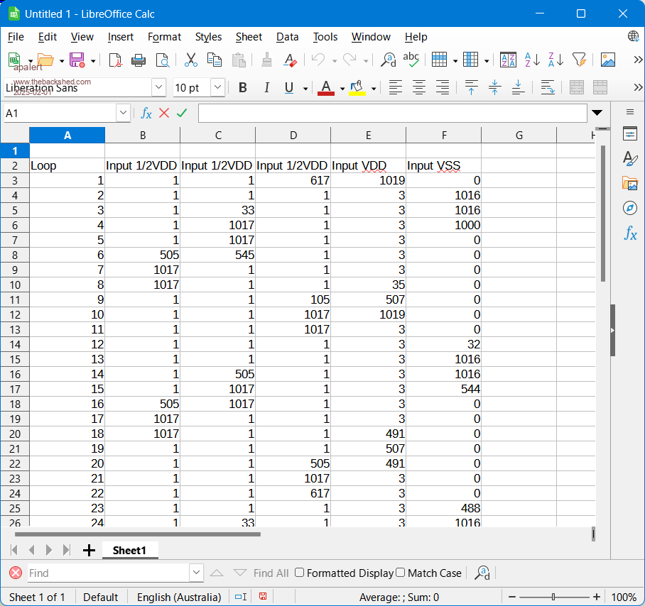

Many thanks for all suggestions, new version of code below. Hours have been spent tweaking. New ADC chip tried, wiring triple checked. Unfortunately output is still garbage :(
Below the code is a table of data returned. I put the code in a For x= 1 to 40 loop and ran it multiple times with 1/2VDD, VDD and VSS test voltage inputs. There is a curious pattern to the garbage!

P.S.: I think in `SPI2 OPEN 100000, 0, 10` the 10 bits is the problem. The bit width refers to whether you read/write bytes (I read/write bytes) or 16 bit words to communicate with the SPI device - it is not related to the bit depth of your ADC.
Posts: 6627
Posted: 02:15am 02 Feb 2025
Including the start bit, you need 4 bits to set the configuration, one null bit and 10 data bits
By adding a low bit before the start bit, you have 16 bits nicely aligned
You can choose to use 8 bit spi or 16 bit spi. Either will work,

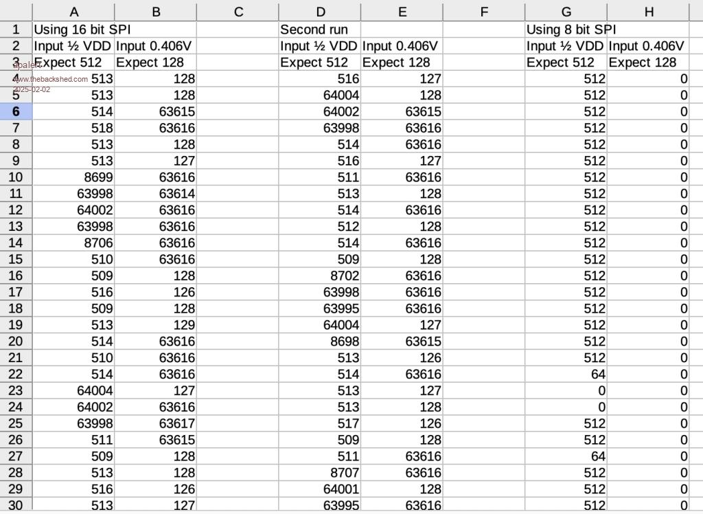

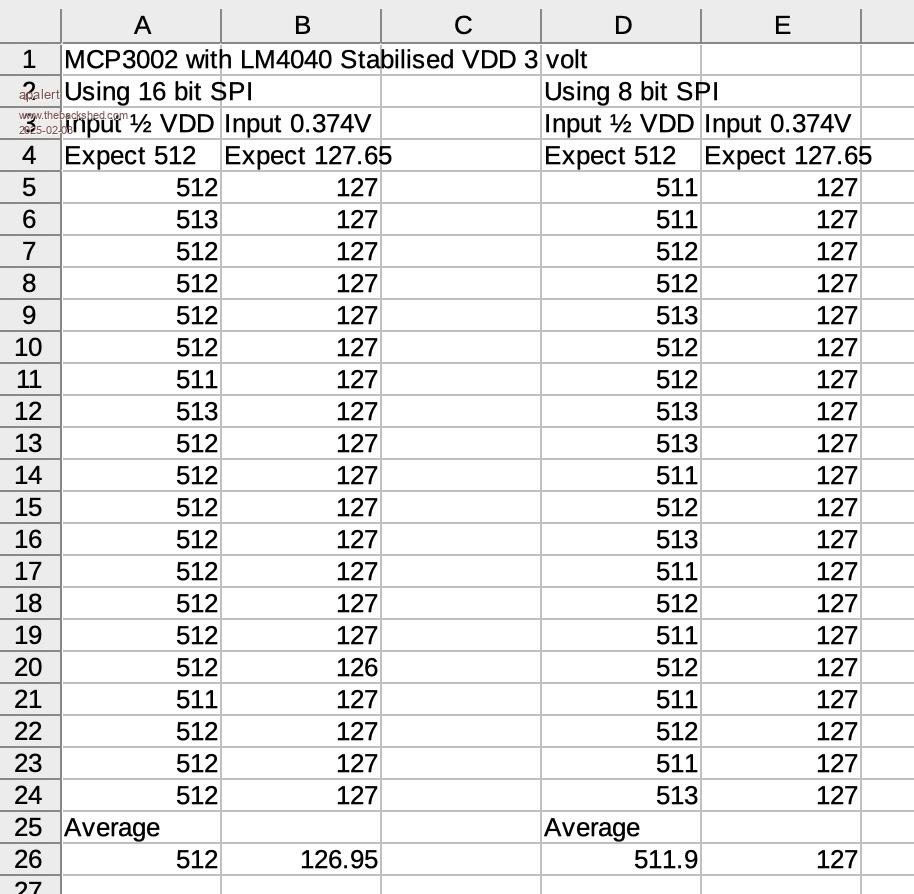

First time I have seen a result using 16 bit SPI. Playing with pauses all through the code varied correct data from 9/20 readings to 15/20. When I say correct, they are a tad off, expected 512 actually ranges from 508 to 515.
8 bit initially gave about 2/20 matching expected result. Playing with pauses lifted that to 18/20. And the good results were perfect 512! Second channel not working with the 8 bit though.
The way there is a run of good results then bad has me baffled. It's not related to run time.
Yes, I did have to cycle CS pin between reading the channels.
Many thanks

 'The first clock received with CS low and DIN high will constitute a start bit.
 'The SGL/DIFF bit follows the start bit and will determine if the conversion will be done
 'using single-ended or differential input mode. The next three bits (D0, D1 and D2) are
 'used to select the input channel configuration.
 'If necessary, it is possible to bring CS low and clock in leading zeros on the DIN line
 'before the start bit. This is often done when dealing with microcontroller-based
 'SPI ports that must send 8 bits at a time. NOTE THE FIRST "0" IN TX!
 'BY INSERTING ONE "0" BEFORE THE START BIT, THE OUTPUT MSB WILL START DIRECTLY WITH B9
 'OF THE OUTPUT CODE. (No Null Bit before the Output Code.)
 'The device will begin to sample the analog input on the fourth rising edge of the clock
 'after the start bit has been received. The sample period will end on the falling edge
 'of the fifth clock following the start bit.
 'Once the D0 bit is input, one more clock is required to complete the sample and hold
 'period (DIN is a “don’t care” for this clock). On the falling edge of the next
 'clock, the device will output a low null bit. The next 10 clocks will output the result
 'of the conversion with MSB first.

apalert
Joined: 06/07/2023
Posts: 47
Posted: 09:31am 03 Feb 2025
  TassyJim said  I forgot to mask off the higher bits in the 16bit code
data0 = data0 AND &h3FF
etc
doing that will get rid of the obviously wrong readings.
In the 8 bit version I should have masked of bits for each SPI read before adding them together.
Jim, did as you suggested and you have nailed it! Results are amazing.
Initially results were +/- 3. However I stabilised VDD on the VDC at 3 volts with an LM4040 and forced Pico into PWM mode while reading, now we get +/- 1 as per spec sheet.
Was able to remove all pauses and bring clock back up to 1000000. Time to take 20 readings around 7.5m/s when not printing result of each loop.
Hard to say which is better, 8 bit SPI or 16. Accuracy seems the same. 16 bit is a tiny bit faster.
