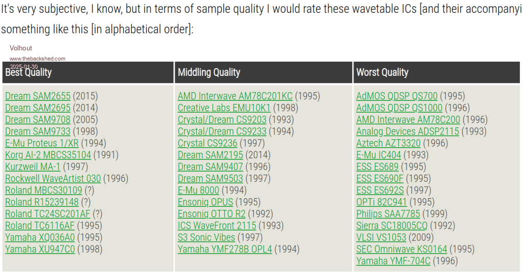

@Peter,
There is a sound quality difference between the 1053 that is implemented in PicoMite, and the SAM2695 when it comes to MIDI.
See this
I can imagine people looking for the SAM chip.....

The VS1053 and SAM2695 are similar devices, with the SAM2695 having more advanced MIDI capability, including a second bank of Roland MT32 compatible instruments.
