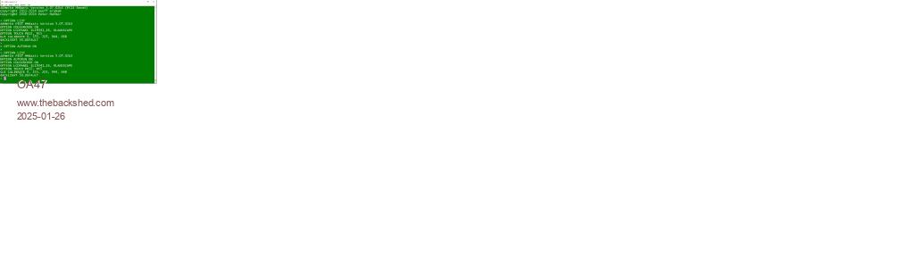

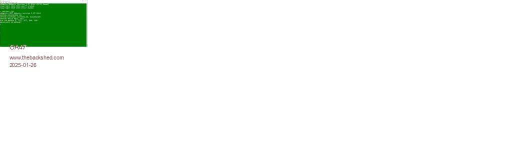

I have just noticed an issue with (PC13Reset) in that if I set OPTION AUTORUN ON it is lost when power is removed.
After applying power.

I vaguely remember a flat coin cell causing a problem.**
Replaced the cell holder with a CR2032 one. Lasts much longer.
** I guess all coin cells are flat but you know what I mean ;)

A grounded PE3 will switch to the Serial Console and disconnect USB console on the normal firmware. Should not do anything on the PC13Reset software.
Options are still stored in battery backup ram so option AUTORUN is lost if battery is gone. Use MM.STARTUP to ensure a dead battery is not fatal.
SUB MM.STARTUP
OPTION AUTORUN ON
END SUB

New battery seems to have been the answer to the AUTORUN issue.
  Quote  Options are still stored in battery backup ram so option AUTORUN is lost if battery is gone. Use MM.STARTUP to ensure a dead battery is not fatal.
SUB MM.STARTUP
OPTION AUTORUN ON
END SUB
Have added to the code.
