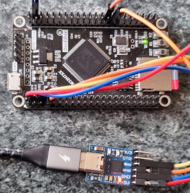

Is a core temperature of 50°C normal?. Ambient temperature in the room is about 23°C.
Am I using the latest Firmware?

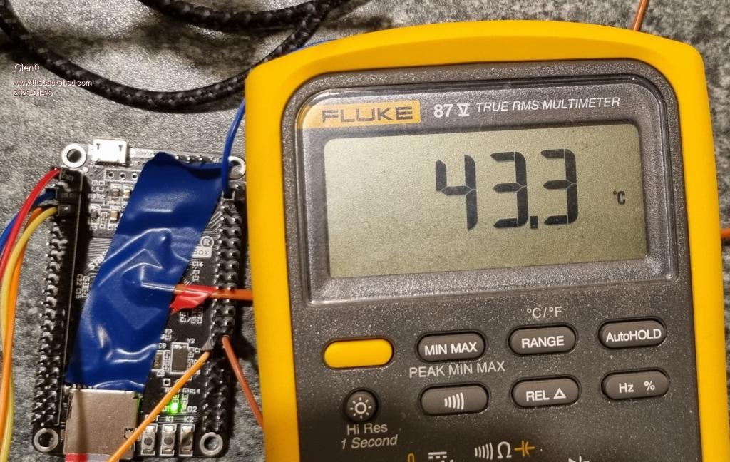

That does look wierd but I think my figures are realistic.
I measured the surface temp for about half an hour and this is what it got up to.
Is there an erase program like flash nuke for this micro.
I think I have another H7 somewhere. If I can find it it I'll test it as well.
What is the latest FW version?

Found the other H7 and loaded Version 5.07.02b1.  Measured the surface of the processor, after 30 minutes it got to just over 42°C

Looks like it's normal for these things run quite warm. I will monitor the temperature when I get it to do some real work.
Posts: 9238
Posted: 09:19am 26 Jan 2025
If you get nervous put a little sticky heatsink on it. It won't do any harm anyway. Remember, the die temperature is always higher than the package temperature, and that is the most important figure. The package is losing temperature to the board by conduction and the surrounding space by air convection and radiation.
