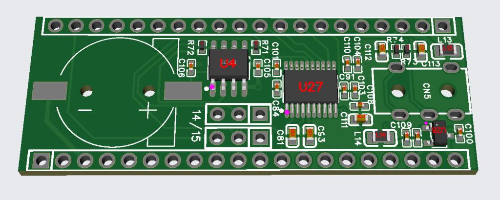

Another quick design
Schematic
ef24a008-bf00-4508-9bfe-93c89e591622.pdf
OPTION AUDIO I2S GP6,GP5
OPTION SYSTEM I2C GP14, GP15 (or GP26,GP27)
I'll get some made to test the I2S bit as this is a new module. Assuming all OK I'll post the gerbers etc.
Plug a Pico2 into this and this into a Waveshare display and you have everything needed for a high quality music player

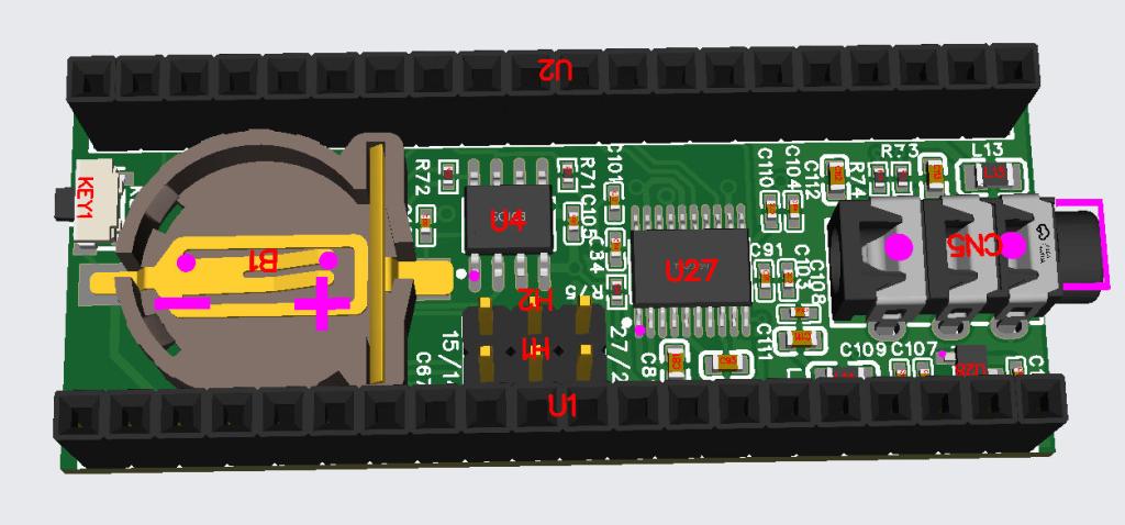

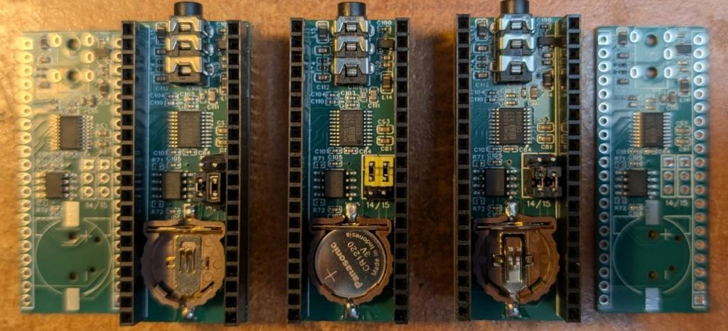

The boards have arrived and work perfectly. I2S audio and DS3231 RTC on a simple Pico "Hat". Since getting these built I've also added a miniature reset switch but you can omit that on the BOM if not required.
NB: the BOM includes simple 20-way headers. I omitted these and used long-pin variants so the boards can be stacked. I can't find a part number for these on JLC/LCSC. As always, omit any parts you prefer to solder yourselves to save cost - Audio jack/battery holder, jumpers etc.
The underside of the board specifies the option commands need to configure.
The PCM5102A I2S DAC runs off its own linear regulator with extensive decoupling/filtering and audio quality is superb.
The boards could be hand soldered but use numerous 0402 parts so pretty tricky.
OPTION SYSTEM I2C GP14,GP15 or OPTION SYSTEM I2C GP26,GP25
NB: I will be enabling I2S audio on all Pico variants (RP2040 and RP2350) in a future release as it is SO GOOD

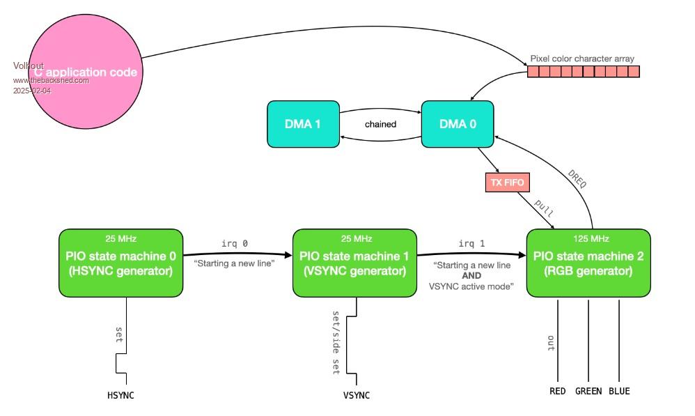

In 2040 VGA this I2S occupies both PIO's correct ?
Volhout
PicomiteVGA PETSCII ROBOTS
matherp
Joined: 11/12/2012
Posts: 12059
Posted: 01:33pm 04 Feb 2025
Correct, but it is a user choice to use it rather than PWM, VS1053, or SPI DAC
Or can it be a separate application on the VGA PIO? What are the limitations other than number of program slots?

When there is a state machine in that pio free (seems so), and there are program memory locations (there are ony 32 total, 31 used) available then both may be combined. How large is the I2S code ? Does it use only 1 state machine ?
I looks hopeless, but what is the size of your I2S code.?

VGA is 16 instructions and uses a couple of DMA channels
I2S is 7 instructions, doesn't use DMA, but uses a combined TX FIFO

But it requires the ARM to support VGA heavily. The VGA data is coming from the DMA, but every line requires 2x support from the ARM: number of pixels, and timing of HSYNC. the use of OUT PC,5 gives the possibility to jump everywhere in the program. An they use the dark_loop: for all timing loops.
I also got what you are trying to do. Assemble the VGA and I2C in the MMBasic assembler, and write the binary blob into PIO memory. Smart...
Good luck, I hope it works.
