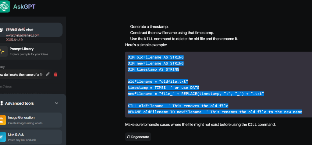

I'm editing this camera program written by Led_bloon. I'm trying to get it to generate automatic jpg captures that are sent to the B: SD card. I figured out how to rename the Test.jpg file after a fews days of trying (LOL , I'm very rusty).
I joined chat GPT and asked " how do I use a timestamp that varies as the name of a file" The answer gave me a clue.
here is the program. down around line 60 I have copy "*" to "b:" which i found out was illegal.  I tried to directly enter copy "*" to "B:/test".  It starts to copy but hangs, and never completes.
> copy "*" to "b:"
Copying 18-01-2025 17:50:32.jpg......just hangs here
I'm wondering is the name of my jpg file incorrect?
here's my screeen from chat GPT.  I can't find any books on basic so chat GPT helps with concepts.
I hope this helps someone.  My thanks again to Led_bloon!

A Peter often says, if you can reduce this to the smallest possible program that displays the behavior (this is not that, necessarily), it would help us debug it.
Also, Code tags significantly improve legibility:
' WebCam.bas V1.4
' I2C interface to ArduCam
' NB Have reverted to polling for WEB comms
LongString CLEAR buff%()
WebService
If Inkey$<>"" Then Exit
'save "b:/TEST.jpg"
save"Test.jpg"
dim newfilename as string
newfilename= datetime$(NOW)
print newfilename
rename "Test.jpg" as newfilename+".jpg"
copy "*" to "b:"
SPI CLOSE
I2C CLOSE
Print "I'm done!"

my option list
> option list
WebMite MMBasic Version 5.07.08b15
OPTION WIFI NETGEAR57, **************, PICOE6614C311B5
OPTION TCP SERVER PORT 80
OPTION TELNET CONSOLE ON
OPTION SDCARD GP22, GP10, GP13, GP11
when I try
copy "*" to "b:"
i get this
[66] Copy "*" To "b:"
Error : Invalid in a program

In sub SaveImage:
' NB NO spaces in the filename! Hence '>' (or any other printable char)
Open "B:/"+Date$+">"+Time$+".jpg" For Output As #1
....rest of code....
' That's it - throw out anything else you have added for this
' Wouldn't hurt to check that the SD card is operational at the
' start of the program.
led
Miss you George

hello Led_bloon. Thank you for the response.
I added your edit
save"Test.jpg"
copy "*" to "b:"
SPI CLOSE
I2C CLOSE
Print "I'm done!"
when I run the new edit I get the error message
"[66] Open "B:/"+Date$+">"+Time$+".jpg" For Output As #1
Error : The logical drive number is invalid"

A further problem character in the file name is ":"
Suggestion:
Use a global variable counter and increment for each file capture
(the files on disk will be system time & date stamped).
NB On a power cycle or reset, the counter variable will be reset to zero
and files will be over-written. Look at saving counter value in flash
with VAR SAVE & VAR RESTORE commands.
Dim img%
Sub SaveImage
 INC img%
 Open "B:/"+Format$(img%,"%08g")+".jpg" For Output As #1
Edited 2025-01-20 10:39 by led-bloon
