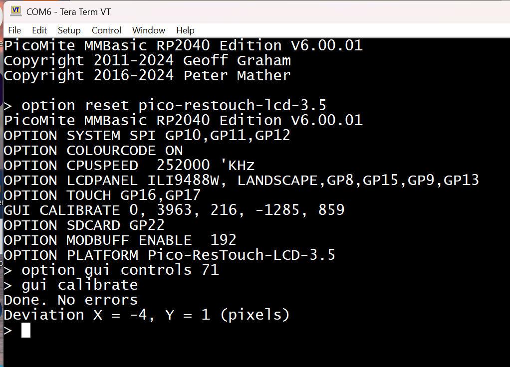

Posted: 08:16pm 17 Jan 2025
Another strange behaviour found:
PicoMite MMBasic RP2040 Edition V6.00.01, Pico-restouch-lcd-3.5
After resetting options and re-establishing options for the panel AND setting
OPTION GUI CONTROLS 71 the old problem with GUI CALIBRATE occurs ...
Error : Touch not calibrated
in a loop after the first calibration point is touched.
If GUI CONTROLS is set to 0, calibration works ...
Edited 2025-01-18 06:16 by ville56
73 de OE1HGA, Gerald

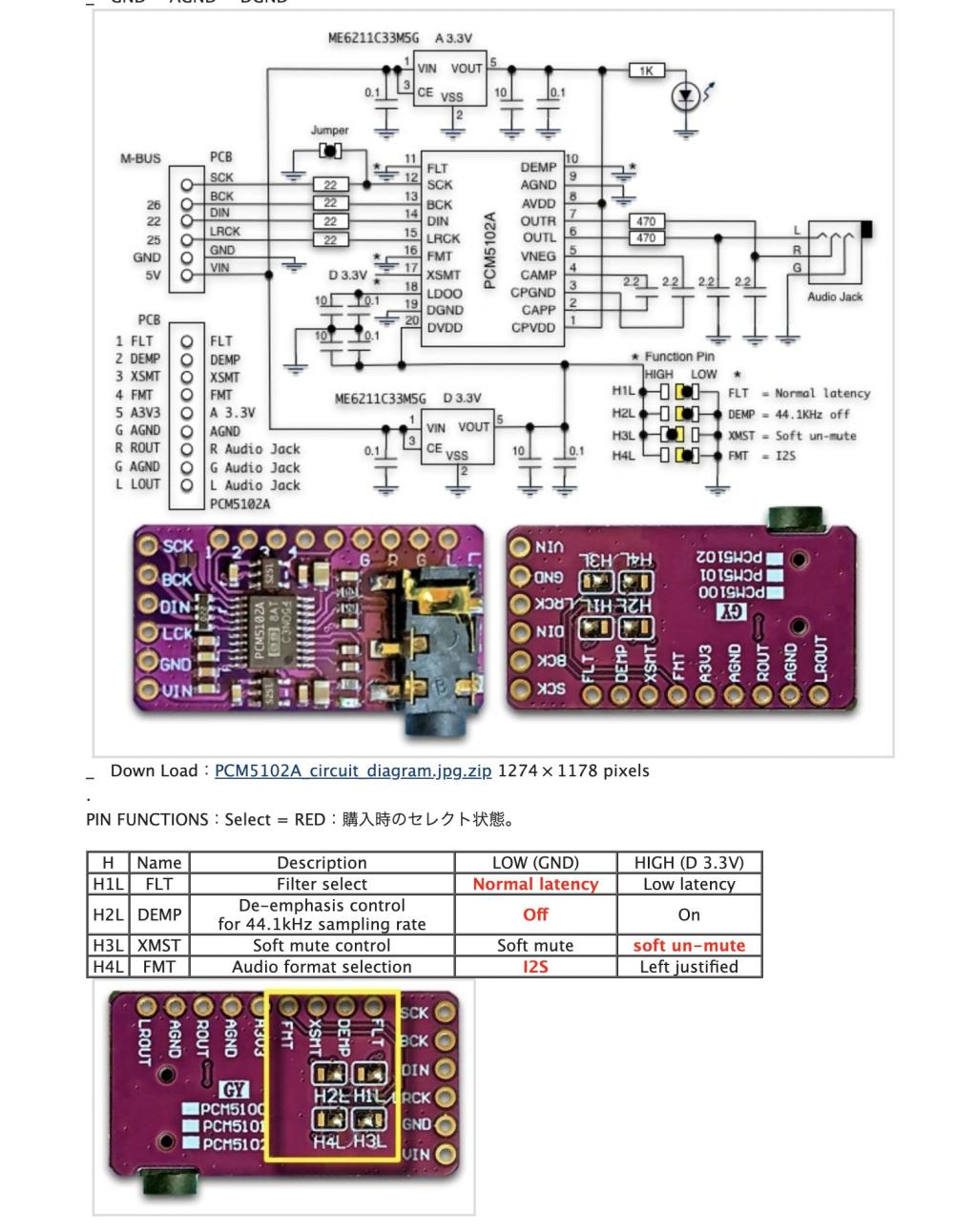

Posted: 08:27pm 17 Jan 2025
Is it possible to implement in V6.00.02 sound on I2S DAC?
PCM5102 TDA1387
Posts: 11785
Posted: 08:25am 18 Jan 2025
  Quote  Is it possible to implement in V6.00.02 sound on I2S DAC?
PCM5102 TDA1387
I have looked at this but to work properly it relies on the processor running at specific speeds to allow the 44100*64*8 master clock rate for the PIO. These speeds are incompatible with VGA and HDMI.
Given that VS1053 is fully supported I don't intend to pursue this further
  Quote  Another strange behaviour found:
Can't replicate

Posted: 12:20pm 18 Jan 2025
PCM5102 TDA1387
And at what sampling frequency is the data updated for sound on PWM or for SPI DAC?
For the I2S bus, it is not at all necessary to adhere to the exact flow frequency; it is possible to transmit data packets at a higher clock frequency with the required sampling period.
Edited 2025-01-18 22:38 by javavi
Posts: 11785
Posted: 12:42pm 18 Jan 2025
Sorry, but I've had a look at it and made a decision. If you want to pursue it further the PicoMite source is on github. The MMX port of MMbasic fully supports I2S output as that chip has a proper I2S module. The Rp2404/2350 can only do it using PIO

Posted: 01:01pm 18 Jan 2025
Can't replicate
ok, can't either anymore after a clear_flash. Must have been some garbage left over in the options area, sorry to bother you ....

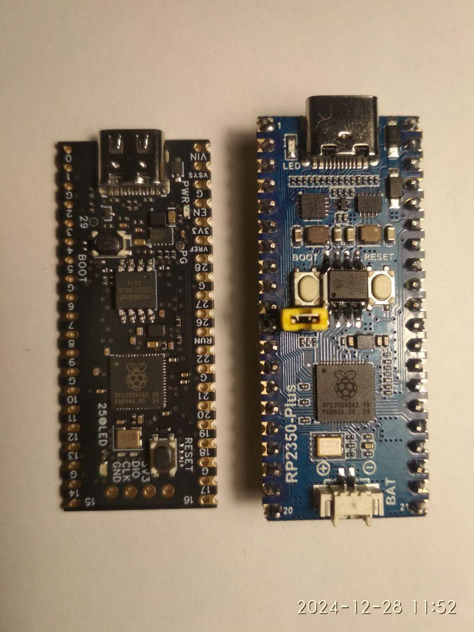

Posts: 3361
Posted: 12:26am 19 Jan 2025
WeAct RP2350A_V20 Completely replace the original PICO2 Raspberry Pi RP2350 RISC-V Hazard3 520KByte SRAM 4 or 16MByte QSPI Flash
Color: RP2350A-V20-16MB AU$7.21 Tax excluded, add at checkout if applicable. Shipping: AU$6.86
https://www.aliexpress.com/item/1005008117237405.html
Edited 2025-01-19 10:34 by phil99

Posted: 01:04am 19 Jan 2025
  phil99 said  WeAct RP2350A_V20 Completely replace the original PICO2 Raspberry Pi RP2350 RISC-V Hazard3 520KByte SRAM 4 or 16MByte QSPI Flash
Here is a QSPI flash installed in a large case, onto which a PSRAM microcircuit can be soldered on top.
