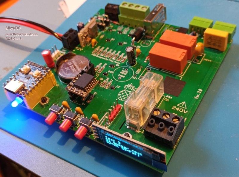

This is intended to be the replacement for the aquarium controller that I built some time ago. That had a few failings when I finally got round to using it, not least the reliability of WiFi on it. I decided that a simple display together with the ability to set the time without connecting it to a PC would probably be enough.
Then I started thinking about changing the lighting. Originally the tank had just a white top light, which was insufficient for growing plants, especially as the back of the tank was in shadow from a rather nice filter system that runs the length of the tank just above the surface of the water. This is a 5V fitting. I added a commercial  RGB fitting closer to the front of the tank and lower, to both boost the light level and shine some of it back into the tank. That is 12V. The aquarium controller had too much volt drop for the white fitting and I eventually had to disconnect the ULN chip and lace a mosfet up underneath the board.
The latest idea is to have both a white 12V strip and a WS2812B strip in the same tube, slightly bigger than the original white light and mounted a bit lower. A second strip of WS2812B fires upwards along the back onto a light grey card, giving a programmable backlight. I experimented with this and it looks good. It doesn't need much brightness so there isn't a lot of load on the 5V rail.
The prototype version is runnable, but I've made several enhancements to it since. I've made it more general purpose, hence giving this board its own thread. I've also created a test program so if you build one you can check that it works before using it in a project. It's handy to have in a flash slot as you can toggle the outputs. I did this to close the relays when insulation testing the mains side.
Have a construction pack. :)

The next stage has now started. I'm copying the existing, working, program onto this and modifying it for the different hardware. It doesn't have to be a complete system, but quick to swap over. A lot of this is working now but I want to make a few mods and hang some LEDs on it for testing, having swapped the links to make it RGB output.
After that, I build the final version. This will be cut down, only including what I need and ready for the WS2812B lighting. I've already written a lot of the final software so that will be going onto it. At the same time I'll get the final lights ready and test it with them connected via their plugs. I'll have to take the relays off the old board but they should come off ok.
Finally, swap the whole system and watch the fish smile in their new disco. :)

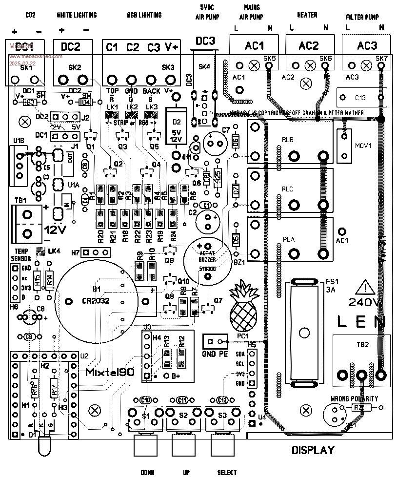

Some minor issues.
1/ Some traces are close to screw hole on top side. Requires using a nylon washer.
2/ Depending the USB A cable/device the low side switching (GND) may not work. Some devices have shield connected to GND, and shield is connected to PE. Can you prevent a PE loop, and thus no switching on the USB-A connected device ?
PE is to GND (gerber). That means that the front USB (pico zero) is not PE protected. Am I wrong ? I would hard connect GND to SHIELD, and high side switch 5V on USB.
3/ when you add a resistor (1.5k) from GP12 to GND (Vmax = 3.6V), you do not need LK1/LK2/LK3. Or 1.2k if you use a shottky diode for D2.
These are minor issues though,

The highlighted screw is very close to the tracks, yes. Agreed that an insulating washer is recommended here.
The USB-A socket has a specific use - it feeds a DC motor at 5V for a tiny air pump. It's not intended for anything else. This supply has to be switched as it's timed as part of CO2 dosing. The reasons that it's a USB-A connector are that the pump comes fitted with a moulded USB-A plug and there's no space for anything wider!
I don't think I should connect GND to PE as that would short out any EMC capacitor in a SMPS that may be feeding it. I was told that it's not good practice unless you have control of the type of SMPS. On the other hand, touchable metal in the vicinity of the mains conductors should be connected to PE for safety. I can't win. :)
There is a PE-connected barrier trace between DC GND (which is floating) and all PCB traces on the mains side, top and bottom of the PCB. Connecting to the USB-C connector is exactly the same as plugging a Pico into a PC.
The series resistors GP12 and GP13 are simply protection resistors for driving the WS2812B strips. D2 drops the voltage to the strip to the point where the Vin(high) for the data pin comes within the maximum output from the Pico. These strips are designed for 5V so follow the rules for 5V TTL inputs and shouldn't really work properly from 3V3. However, I've had one that didn't work yet. :)  The resistors and D2 aren't really needed, but they are cheap.

A few changes have been made and new PCBs are on order.
Now on version 3.1
* More clearance around PCB fixing holes.
* DC GND can optionally be linked to PE (only really recommended with linear supplies).
* USB supply is now high-level switched.
* MOSFETs that might be used for PWM outputs now have series gate resistors to reduce stress on the GPIO pins.
* A "wrong polarity" neon has been fitted internally for those countries with reversible mains plugs. If the board is in an enclosure you will probably need a tiny hole above the display to see it. You may have to change RZ to suit your mains supply voltage.
* The RTC can now be unplugged even when modified to use the CR2032.

The wrong polarity mains can also be fed to an adc pin (via a 5meg/22k resistor divider) and the zero can show on lcd.
Posts: 9238
Posted: 04:40pm 22 Feb 2025
As all the pins are used I'd suggest a bit of PCB hacking to get rid of the buzzer.
Cut the trace to GP2  (the buzzer)
Cut the trace to GP29 (S1)
Link S1 to GP2 (to move S1 onto GP2)
Use GP29 as the analogue input.
I think that could be done quite neatly. The high value resistor could be in a bit of heatshrink underneath the PCB. You will need to link GND to PE for this.
An opto-coupler with a capacitive dropper put across the neon might be another way. You can use a digital input then.
I wonder if the Pico could detect it capacitively using a few turns of wire round the neon?

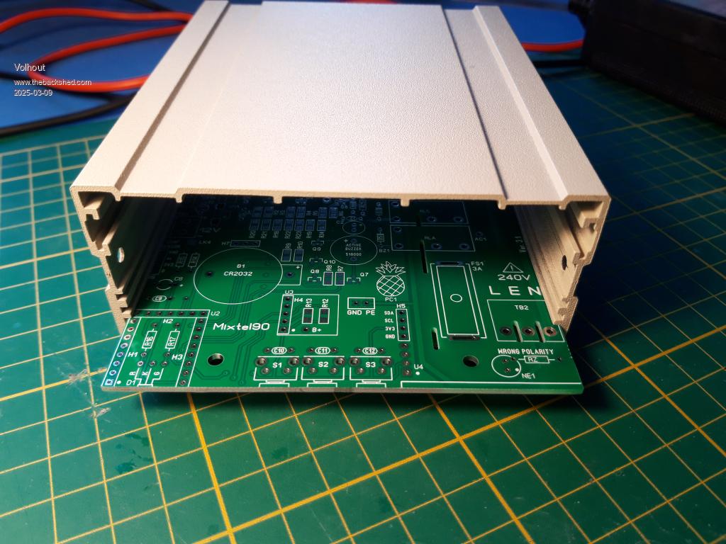

The board arrived in good shape. Unfortunately, the housing I had envisioned is going to work, since you used every square milimeter, also the edges...
To be continued...

The board arrived in good shape. Unfortunately, the housing I had envisioned is not going to work, since you used every square milimeter, also the edges...
To be continued...
