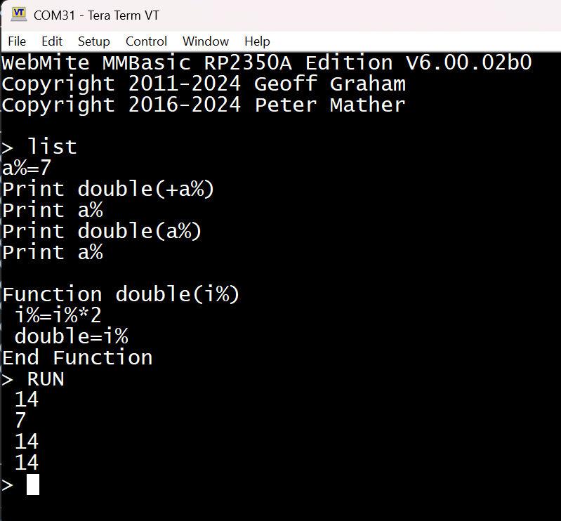

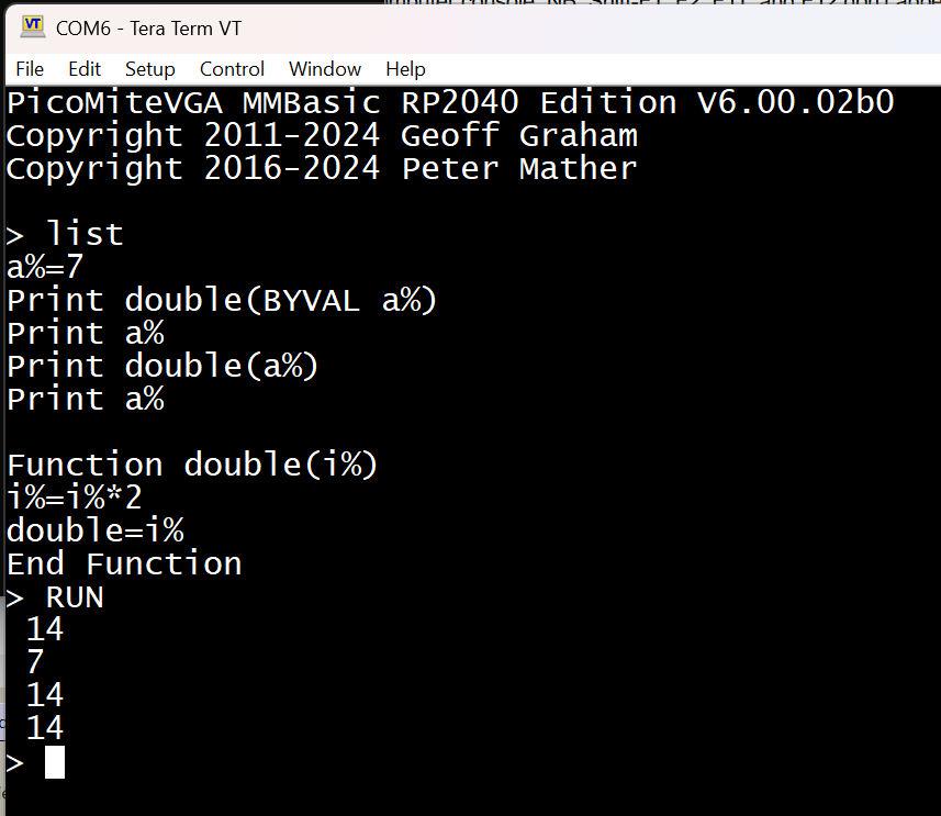

I've also played with this - does it make sense?
Note that BYVAL is effectively a unary operator and must be included in the call and can't be specified in the subroutine itself

  matherp said  I've also played with this - does it make sense?
Note that BYVAL is effectively a unary operator ...
Do we need that? Isn’t that identical to
a%=7
Print double((a%))
Print a%
Print double(a%)
Print a%
Function double(i%)
 i%=i%*2
 double=i%
End Function
Isn't a note in the manual enough?

Posts: 4394
Posted: 01:07pm 15 Jan 2025
I wouldn't, but <shrugs shoulders>. Is there a particular difficulty in adding adding it to the SUB prototype like VB ... though even then I do wonder whether you should.

Posts: 11785
Posted: 01:13pm 15 Jan 2025
  Quote  Is there a particular difficulty in adding adding it to the SUB prototype like VB
Yes!!!!!!!

Posts: 11785
Posted: 02:26pm 15 Jan 2025
  Quote  It's the level of detail in your reply that I find most helpful . I'll get my coat.
You must know the code as well as me now. As far as I can see based on a quick look it would be a complex change to definedsubfun
Posts: 4394
Posted: 02:50pm 15 Jan 2025
  matherp said  You must know the code as well as me now.
I doubt that is true, you've been working with the MMBasic code much longer than I have even if I might have been programming in C longer than you.
  matherp said  As far as I can see based on a quick look it would be a complex change to definedsubfun
OK, right, so probably not a fundamental issue, just an issue of time and willingness which I quite understand, I simply don't have the time even if I could generate the will. In addition it's much harder for the PicoMite (c.f. MMB4L) since you aren't able to build MMBasic on the target platform, the build/test cycle is so much longer.
