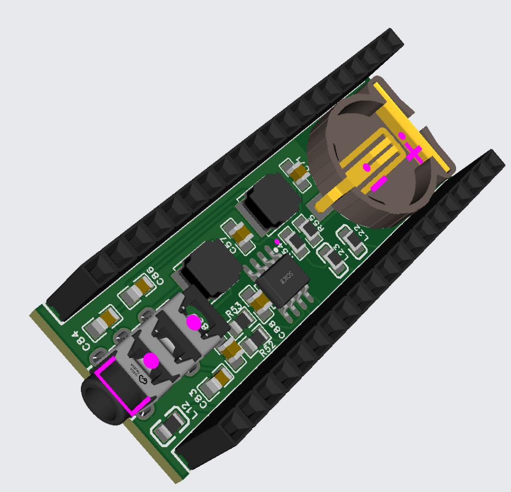

Geoff's VGA board is simple and effective but it doesn't include an RTC or audio output.
This is easily remedied
Gerbers
Gerber_PCB1_2025-01-11.zip
BOM and Pick-and-place
BOM_Board1_PCB1_2025-01-11.zip
Schematic
RTCAudio.pdf
Cost from JLC USD57 for 5 fully built. Can be hand soldered as no parts smaller than 0805

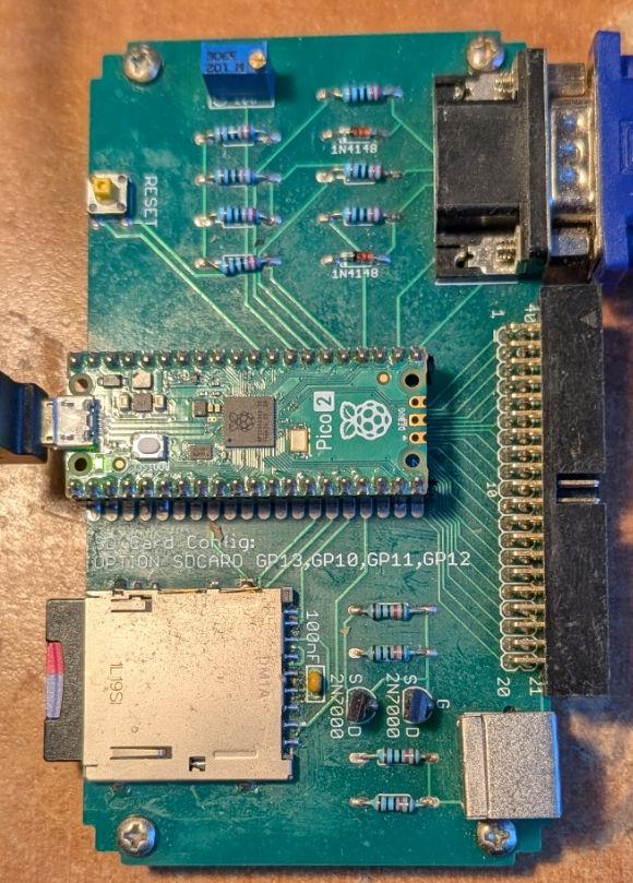

Hi Peter,
It may be me, not understanding the details. But in case you connect audio to GP6/GP7 and I2C to GP14/GP15, VGA reference design 1 configuration is identical to VGA reference design 2.
Makes it a lot easier to configure. OPTION RESET VGA DESIGN 2. In stead of manual configuration.
Posts: 12059
Posted: 10:12am 12 Jan 2025
  Quote   But in case you connect audio to GP6/GP7 and I2C to GP14/GP15, VGA reference design 1 configuration is identical to VGA reference design 2.
Good idea. The previous design is still valid though for use on things like the Waveshare 2.8 and 3.5" displays.

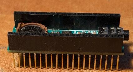

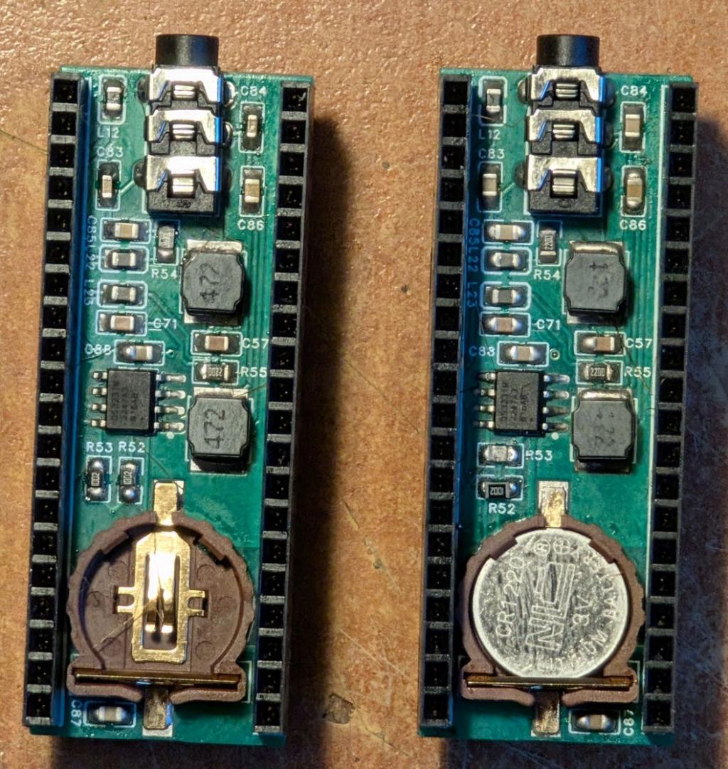

Posts: 12059
Posted: 04:25pm 21 Jan 2025
The boards have arrived and work perfectly.
These were hand soldered and for the first time I used a low temperature solder paste and the heat gun. As you can see it worked perfectly and is pretty much indistinguishable from "factory".
The PCBs cost £4.02 for 5 including tax and postage to the UK
The 20-way sockets I've installed have long legs so the boards can be stacked
There are two variants of the design as posted above.
The last version uses the configuration
OPTION AUDIO GP6,GP7
OPTION SYSTEM I2C GP14, GP15
and is compatible with Geoff's VGA board pictured above and on that board can be completely configured with OPTION RESET VGA DESIGN 2
The previous version is designed to be compatible with various of the Waveshare SPI displays like the Pico-RESTOUCH-LCD-2.8/3.5 and is configured with
OPTION AUDIO GP4,GP5
OPTION SYSTEM I2C GP6,GP7
Edited 2025-01-22 02:28 by matherp
