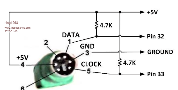

Hello. I want to connect a ps/2 mouse to my cmm2 gen1.
in the documentation i found an doc image.

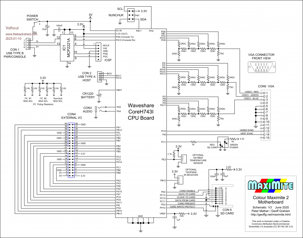

i can connect to pin 33 and 32 and ground on the gpio. but where can i connect the 5v from the mouse?
there are 3.v pins, no 5v pins...

Posted: 03:50pm 09 Jan 2025
I think it means you need to provide 5V.

Posted: 04:05pm 09 Jan 2025
Pin 2 or pin 4 (manual page 10)

Hi
+5V is available at pin 2 and 4 of the 40 pin connector.

Posted: 08:22pm 09 Jan 2025
  Volhout said  Hi
Thank you very much.

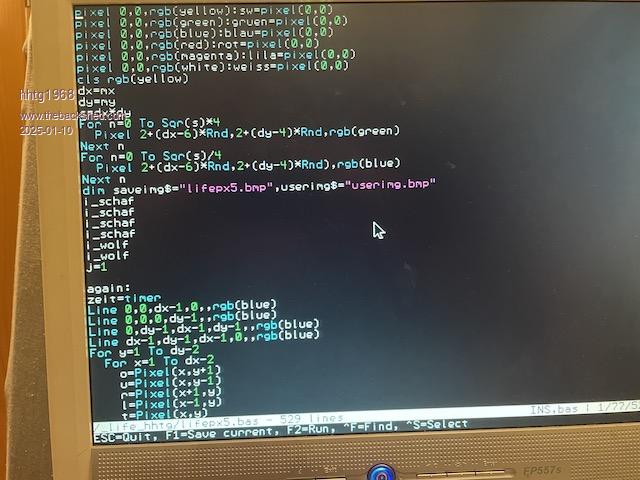

Posted: 09:11am 10 Jan 2025
And it runs well...
you can see the mouse "cursor"...
Thanks again.

Posted: 10:26pm 10 Jan 2025
  thwill said  Just an observation @hhtg1968 but NEXT statements in MMBasic don't require the variable name, e.g. you can just write:
For i = 1 To 10
 For j = 20 To 30
   Print i, j
 Next ' No j required
Next ' No i required
And by doing so you would save 110 variable lookups, which is a worthwhile saving as variable lookup is quite an expensive operation.
thank you for the notice. i had measured it, it is actually faster...
