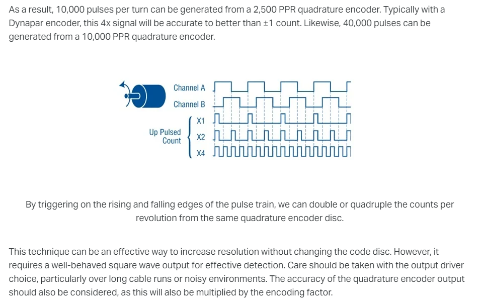

Many of my encoders are 4,096 "line" but in order to also detect direction, there are two (5v) pulse streams that are 90° out of phase. Due to the fact that we then have two rising edges and two falling edges, we have 4 separate transitions. This is where "quadrature" comes from. a 4,096 line encoder now provides 16,384 counts/rev.
Some of my motors run at 6,000 RPM (100 revs/sec) so the PicoMite will need to handle 1.6M+ counts/sec. Granted, it would take a while to hit +/- 31bits but I don't want such a limit if I have an option.
The X4 Up Pulse Count is us
Edited 2025-01-09 01:44 by PhenixRising
