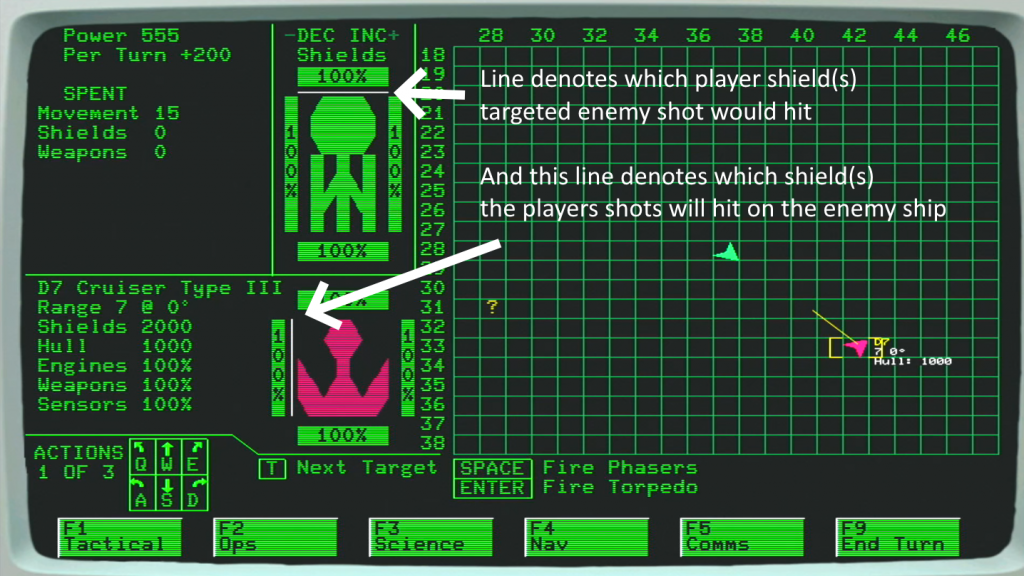

Step 1 was to introduce directional shields (Front, Rear, Left, Right - or Fore, Aft, Port and Starboard if you want to be nautical), which also led to giving the player ship and enemies the ability to point in any of 8 directions (N,NE,E,SE,S,SW,W & NW).
Step 2 was limiting the firing arcs of the weapons, so the player has to bring weapons to bear.
Right away, this greatly improved the gameplay - giving it more of a naval feel. Maneuvering around the enemy to keep your strongest shields facing them, and in turn to try and get a bearing on their weakened shields, introduces far more depth.

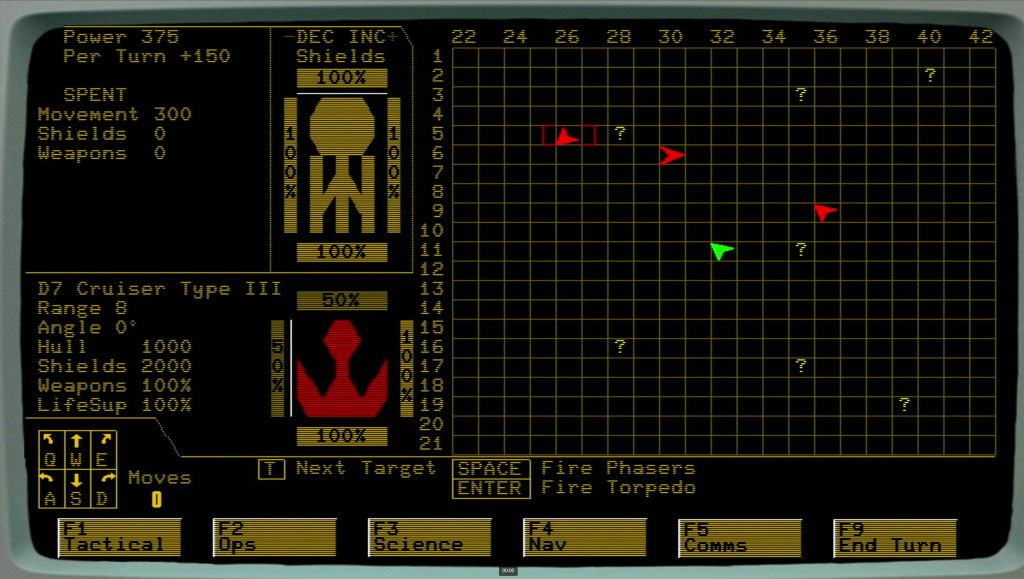

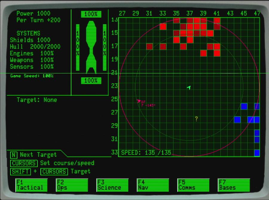

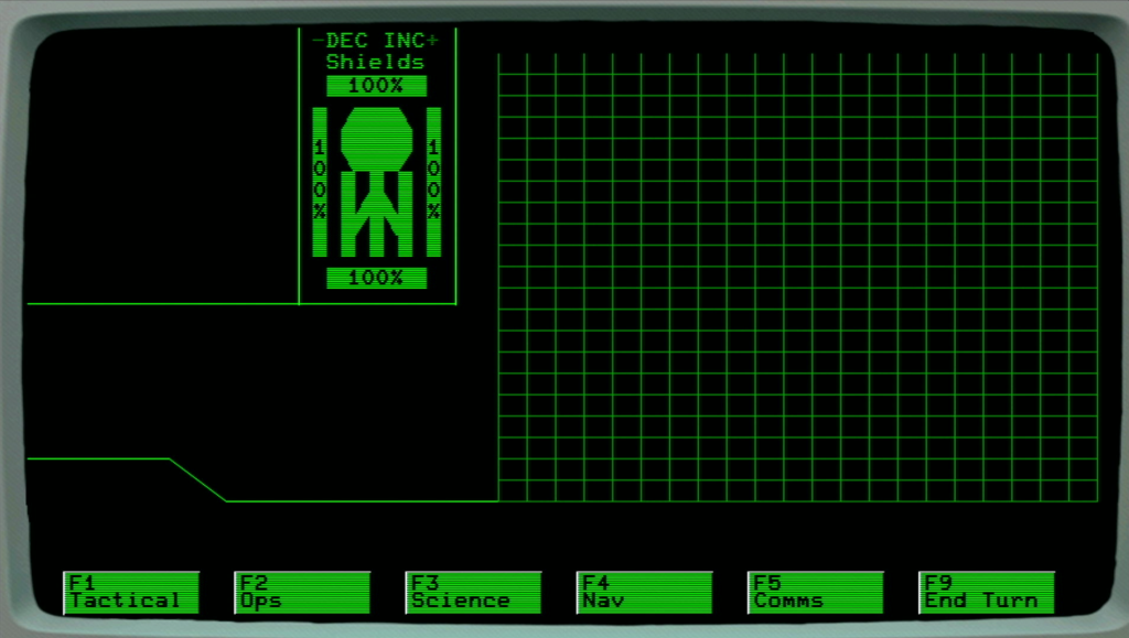

In keeping with the look and feel of the old HP workstation, I remapped font 9 to be a 10 by 20 VT Terminal font, with scanlines between the pixels.
I also created some Pet-SCII like characters that I could use for simple graphics.
I added a fake monitor bezel, to further tickle the nostalgia neurons.
Up until now I had been using two 10x20 characters for each 20x20 pixel grid on the main map (shown above). To simplify this I created a 20x20 font of exclusively Pet-SCII like characters (mapped to Font 10) that I use to draw the map.
Because I also have fond memories of the amber VT Terminals from one of my first jobs, I put in the option to use amber instead of green as the main colour. But I still prefer the green.
So, that's where we are at currently. I'm having an absolute blast just trying out different mechanics and seeing what works. I would never do this for a real project, but it is liberating to be working without any set design or deadlines.

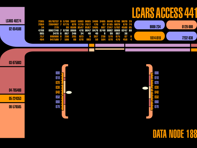

I wonder if it could incorporate some Okudagrams by using the LCARS format for the gameplay?
No idea if it's possible, it's just an idle Start Trek thought on my part

  Malibu said  I wonder if it could incorporate some Okudagrams by using the LCARS format for the gameplay?
Either way, love what you've done there
Thanks!
There's no reason why it couldn't be "re-skinned" with an LCARS interface. It would certainly look cool. I've always loved that look.

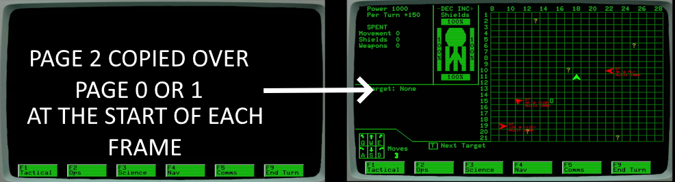

The 1st Generation CMM2 can store 3 of these Mode 1 graphics pages in memory (numbered 0, 1 & 2). I could increase this to 6 pages by dropping down to 8-bit/256 colour mode - but I really like the bezel (which doesn't look as good in 8 bit mode), and  because we are using fonts instead of bitmapped graphics, we don't really need the extra pages.
We can think of these three pages of video memory as three blank sheets of paper. We can show any of them to the user at any time. If we were just to use page 0, then we would be using one sheet of paper - drawing each frame, then erasing it, then drawing the next frame over the top of it. Unfortunately, the user would see the page being cleared for a split second before everything is redrawn, and this would be an annoying flicker on the screen with each redraw.

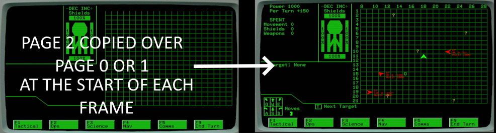

So, to get rid of this flicker, we alternate between drawing on pages 0 and 1, and we show the user the other page. So, if I want to refresh the image on the screen, I show the user page 1, and I draw on page 0. When I have finished drawing, I swap the sheets of paper over and show the user page 0 and clear page 1 ready for the next image. We keep swapping back and forth like this and the user sees a seamless animation with no flicker.
The call to change which page the user can see is almost instantaneous - so you can achieve very high frame rates with this method. This is very common in games programming and is called double-buffering and is critical in action games where sprites are moving around the screen many times per second.

As I mentioned, we have three mode 1 graphics pages available on the Gen 1 CMM2. We are using pages 0 and 1 for the double buffering, which leaves us one more page to play with. Normally we would use this for storing sprites etc. which we would blit onto the main screen as needed.  But because we are remapping fonts and using text only, we don't really need this page just yet. So I use it to hold the bezel image, and when I want to clear page 0 or 1, I just copy the bezel from page 2 over the new screen that I'm about to write to. This clears off any old graphics, ready for a new frame (note the F-buttons are also part of the bezel - as they are the same for every screen in the game).

Next up: I effectively have three 100x100 arrays that hold the contents of the sector. One for ships, one for random objects and one for starbases. Each time I draw the grid around the player, I need to check all three arrays. To speed this up, I created a fourth array which tracks which squares are empty. Given that most of space is empty, I only need to check this single array to see if I can skip looking for ships items or starbases. This shaved another 10ms off the scan time. I just need to make sure I keep the array updated every time I move or destroy a ship.
At this stage I'm down to a fairly respectable 90ms.
I think the lesson here for me is that I jumped to the conclusion that the slow Text writing was the issue - but when I started to test that theory, I quickly realised that I was mistaken. Normally I would have looked at the nested loops first- but in the back of my mind I was prejudiced against the text draw speed - as this was famously slow on old 8-bit computers. But it turns out that it's not an issue on the CMM2. I have learned something here.
Finally, I decide to be a bit smarter about using that spare Display Page 2. About half of the draw time for the screen is drawing parts of the tactical screen that are always present (e.g. the 21x21 grid). See image below:
So I add some logic to draw the static background and save it to display page 2 (see image below). Now, whenever I need to clear page 0 or 1, I copy the background from page 2 - and just draw the foreground text and now the draw time is down to a respectable 45ms - or 22 frames per second. Which should be good enough for animations. The ship movement also feels far more responsive.
