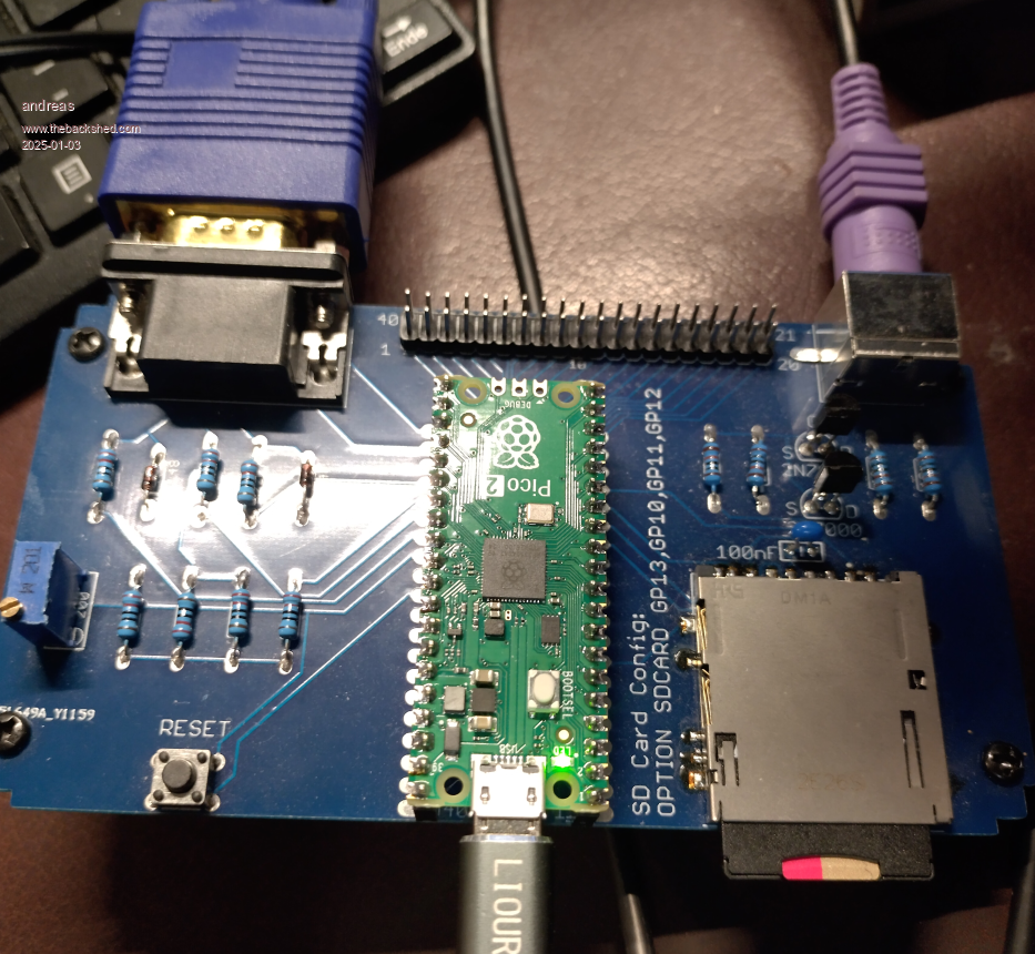

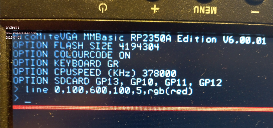

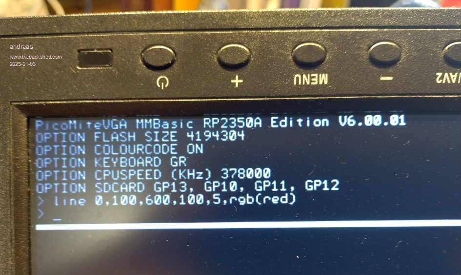

I tried to draw colour lines on a PicoMite VGA RP2350A. When I do cls rgb(red) everything is red - so colour works on the hardware, but the colour within the line etc. commands is always white.
firmware is from 29.12.2024
This is the hardware

Are you in Mode 1 (monochrome)? It works in Mode 3.
For me the surprise is CLS RGB(red) gives a red screen in Mode 1.
Edited 2025-01-03 08:10 by phil99
Posted: 11:32pm 02 Jan 2025
I think although mode 1 is monochrome, the foreground and background colours can be any of 16. vga mode 3 colours are fine

  phil99 said  Are you in Mode 1 (monochrome)? It works in Mode 3.
Thank you for the tip with the mode! After switching to mode 3 everything works fine!
