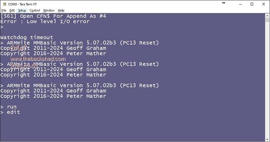

OA47
Joined: 11/04/2012
Posts: 1056
Posted: 12:40am 01 Feb 2025
  Quote  Was it the same as you originally found.
I did try to take a screen shot and lost it with the remote access but I dont think I had to CNTRL-C, there was an error created during a write to the log file with a message something like:
[189] Open CFN$ for Append As #4
Error : A hard error occurred
The console had its banner with a prompt and I typed RUN to no avail and when I typed EDIT it showed no basic program.
OA47
Edited 2025-02-01 11:37 by OA47

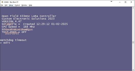

OA47
Joined: 11/04/2012
Posts: 1056
Posted: 11:25pm 02 Feb 2025
I managed to scroll through the TeraTerm screens and found the screen info for the error the other day.
But I have had the program wiped twice since then around 12 hours apart with just the watchdog notification.
Im a bit lost here.
