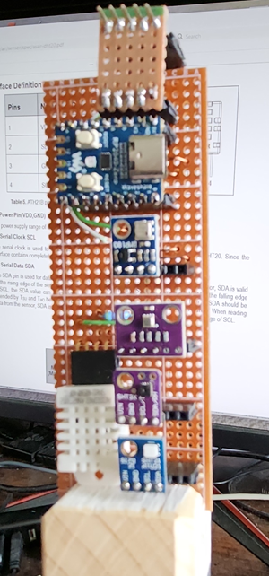

This pair of programs gathers 8 data values from various devices and sends them via 4 Humid commands.
Synchronization is achieved by having a long pause between each group of 4.
It could have been done by including some address bits in each block of 32 bits.
Eg if the data is from a 10 bit DAC 3 values and 2 address bits could be sent in one 32 bit shot.
There is one catch, if the 32 bits = &H27102710 it could be mistaken for the error indicator when
both T and H = 1000. To prevent that whenever &H27102710 occurs flip the leat important bit, or reserve a bit for that purpose.

Data collector and DHT22 Emulator
Print "multi sensor data collector with DHT22 emulator output v02.bas"
Print MM.Info(cpuspeed);" Hz"
' "DHT11 and 22 Emulator for AHT10 input.bas"
'  One pin version. Link DHTpin and Gnd. to other Pico.
'  If wires are short no pullup resistor is needed.
Const DHTpin = MM.Info(pinno GP6)
SetPin DHTpin, DIn, pullup
Print "DHTpin =";DHTpin, Pin(DHTpin)

I have been comparing various sensors, looking for reliable temperature, humidity and pressure in the one chip.
The DHT20 is worth a try but pinout is odd and I will have to make a special socket for it. I need to redo the board anyway so not too bad. I will be dropping the DHT22.
I like it when all the modules can be interchanged easily. It makes comparisons easier.
My test results so far:
Temperature BME280 20.5, HTU21 20.1, BMP180 21.6, DHT22 20.5, SHT31 20.6
Humidity    BME280 50.4, HTU21 63.7,              DHT22 43.4  SHT31 60.8
Pressure    BME280 1011.0            BMP180 1010.2
The temperature on all modules compare very well.
The SHT31 humidity is the most believable so far.
On another BME280, the humidity has gone to 100% without any recovery. I don't expect much better with this one.
DHT22 humidity varies from 40 to 75% depending on the module I choose. All were "new"
Putting the pico at the top stops it's heating upsetting the readings when the cover is on.
Next step is to move the sensors out into the real world.
Sorry Phil, I used normal serial for my link.
