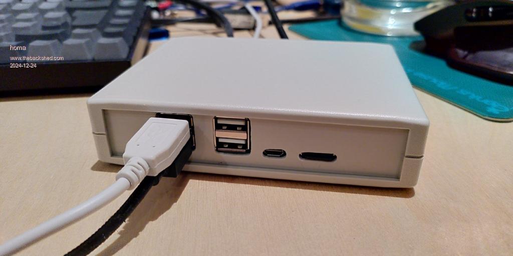

Martin H.
Joined: 04/06/2022
Posts: 1573
Posted: 11:43am 24 Dec 2024
Matthias
if you actually have one left, please let me know
Martin
PS: Maybe it would be enough if I printed the front panel
'no comment

Martin H.
Joined: 04/06/2022
Posts: 1573
Posted: 01:35pm 24 Dec 2024
  Mixtel90 said  If you print the front panel, laminate it and cut it out neatly it can often cover slightly oversize holes in the plastic. I've done this before and it worked ok. For this sort of case you really need to stick the print down then trim it so about 0.5mm of plastic shows top anb bottom and about 1mm at each end. Any reasonable double sided tape is fine.
Yes, there are various good options for creating the front panels.
I was thinking of 3d printing instead of milling and drilling. You can also get a label by changing the filament for the last 2 layers.
Happy christmas holidays
Martin
