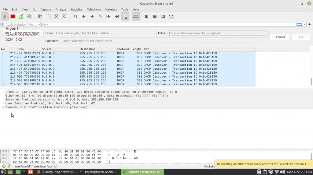

Now thanks to Andy I downloaded wireshark for linux in the software centre and doing a scan on enp1s0 there is no activity. I was fooled at first as the scan was pointed a wsp1s0.
When the S9 is turned on I can see from the led it is trying to broadcast but the laptop just isn't seeing it. So tried out that wifi dongle where it showed up as wifi straight away but no net but even when the etherent cable is inserted in the router wireshark still shows no activty. Also on the bridge the S9 is showing up but the cable from the laptop doesn't show as active.
So if any linux guy's can help out to get this ethernet port going on the laptop it will be great.

The DHCP Discover packets are from something looking for a DHCP server so that it can get an IP address.
So that's why you are not seeing any IP addresses yet, it has not found a DHCP server so no IP address has been issued.
Shove in a manual IP address, mask, and gateway, that should poke things into life.
Or find out what is supposed to provide the DHCP server functionality and check that it is working.
Remember it is very bad news to have TWO DHCP servers on the same network you will get all sorts of IP address clashes. It can be done but you have to limit the DHCP address ranges very carefully on each server.
Many if not most routers will provide a DHCP service, as will a lot of "range extenders" Some are very configurable others not so.

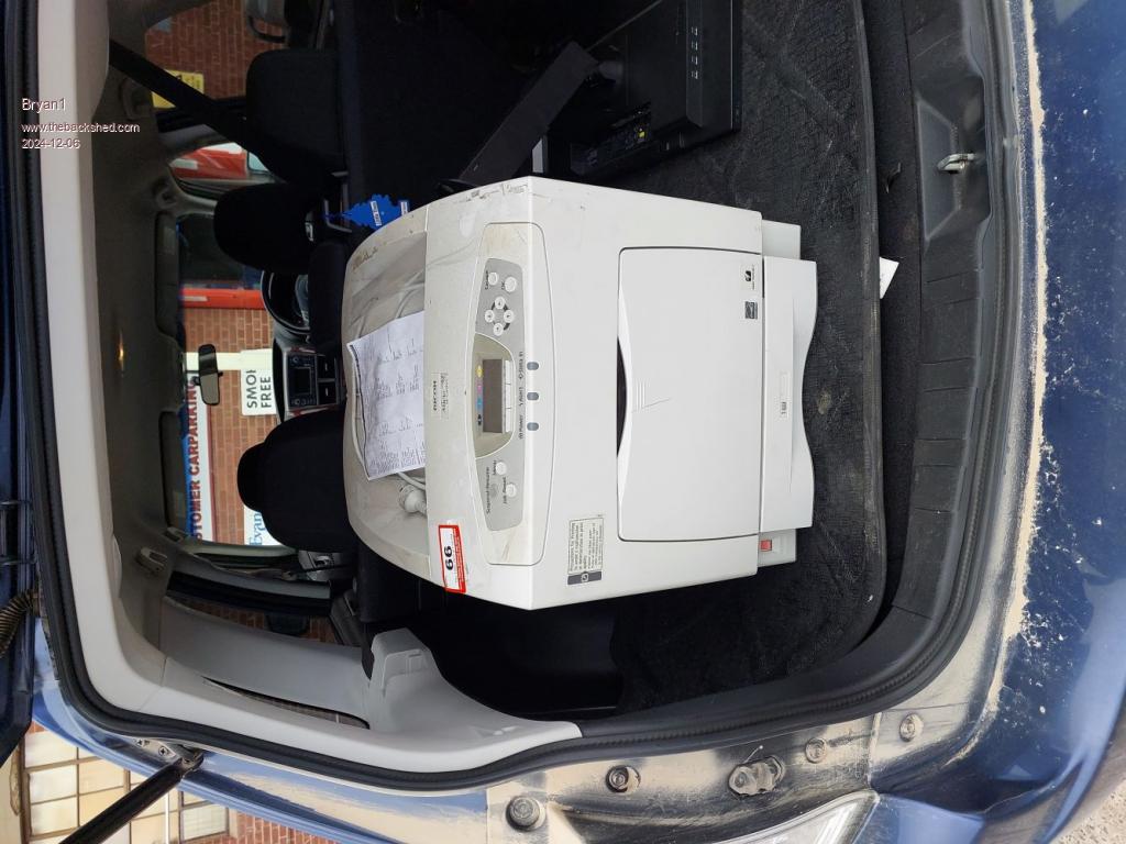

Thanks for the reply Tony   well the cricket is on so no more work today
Well the high lite of my day was picking up a commercial colour laser printer for $12.50
Now I do need to get in contact with a mate as it did take 2 people to load it and with the cyan on 35% and the other 3 on over 50% it's going to print plenty of bottle labels for my moonshine ( now this topic has never been said as I'm not sure if it will fit the standards of this forum) I do make a nice drop and next year I'm going legit just so I can be a conduit for the taxman.
