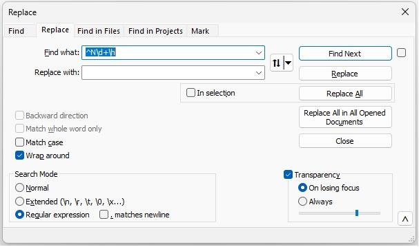

Open the .dnc file in Notepad++
In main menu select Search, Replace
In the popup box put
^N\d+\h
into the Find what box. Leave the Replace with box empty.
In Search Mode select the Regular Expression button.
Click the Replace All button.
All line numbers will be removed.
Apparently
^   means start of line
N   is literal
\d  means digits
+   means match the preceding atom one or more times
\h  means horizontal spaces

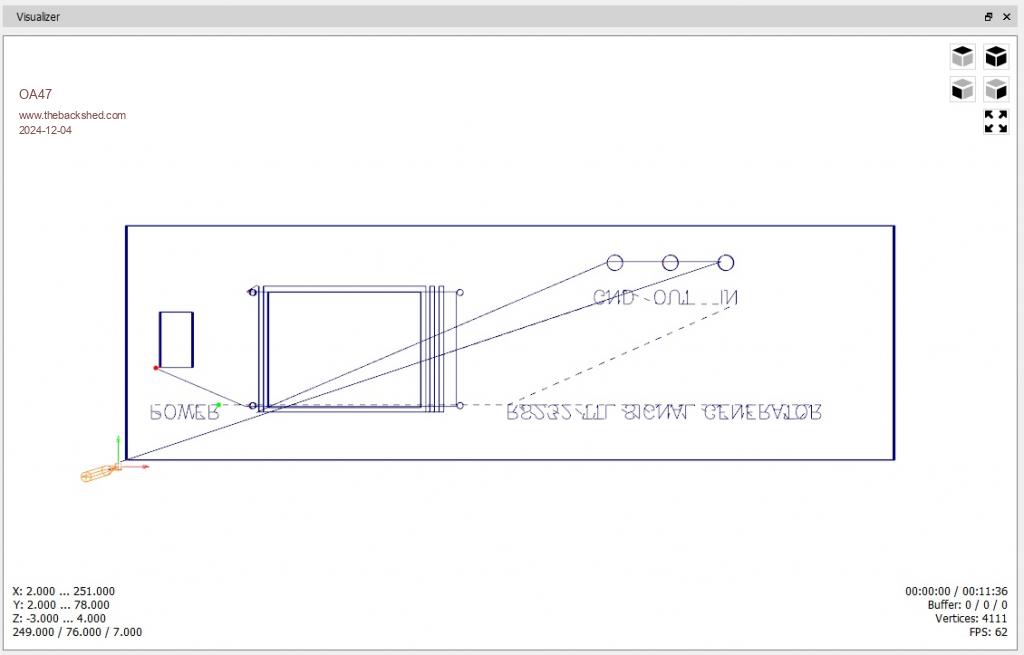

The reason that I want to merge the GCODE is so that I can be sure that the labels are accurately located to the cutouts of the panel. I can view both the cutouts and the TEXT labels in the 3d viewer of the CANDLE software.

  Quote  If you are on windows it looks like Stickfont will generate the letters referencing the machine origin.
Played around with stick font and it looks like it will suit my purposes.
Thankyou disco4now
