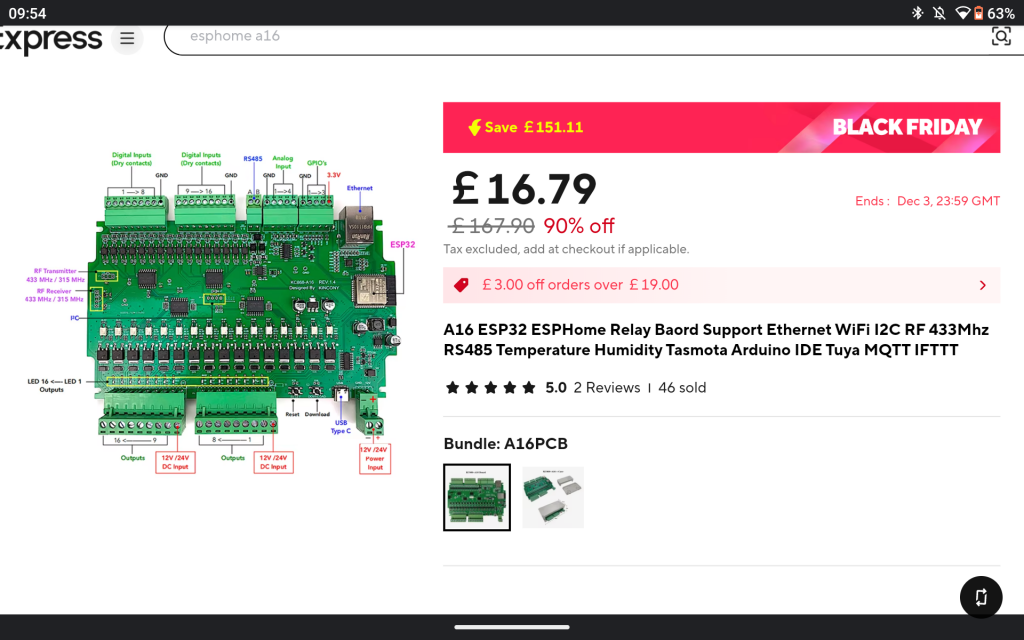

I couldn't resist at this price and they have lots of sample code on their site.

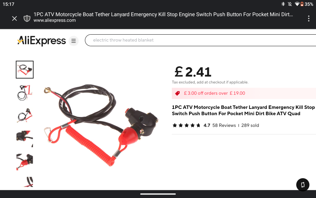

Quazee137
Sounds like you need a lanyard switch:
Have the strap around your wrist. Insert the plug to enable power. Pull your hand away, the plug pops out and power is removed.
