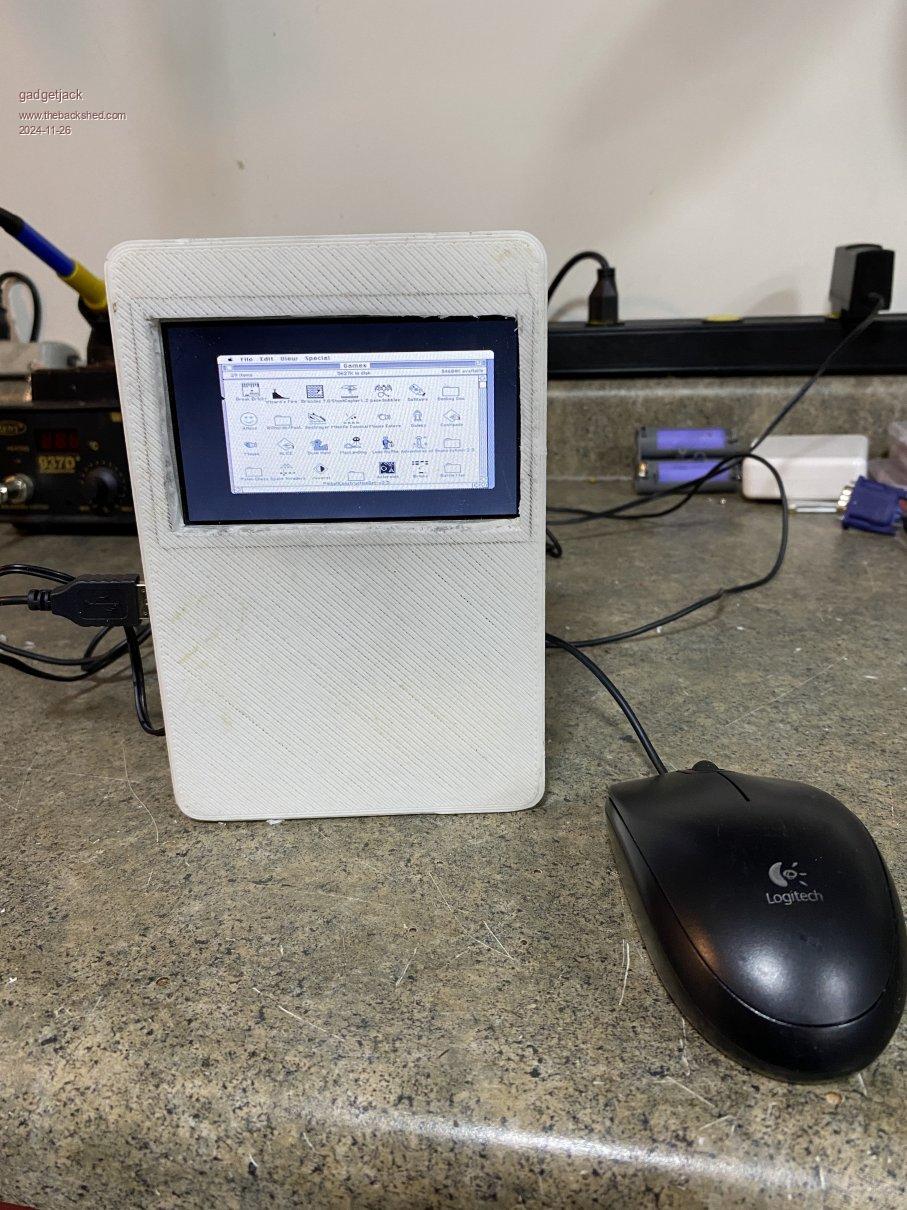

I read a comment a bit back that there were no good emulators for the Pico. I just built this from a new file on github called a Pico-Mac (or pico-micro-mac). It boots to a black and white screen of a macintosh 128k from about the 1985 era. It loads a 30 meg "hard drive" from the sd card. It plays games , does the paint program , and about everything else that old machine did. I got the re-compiled program that lets you use 208K for the machine (thats all you can get from a stock pico). Not a great machine but a good way to pass time for us old retired guys. It outputs in VGA and uses a regular mouse of the usb type. If you have trouble getting the files to compile ( like me ) , i can send the files in a zip. I will write what is in the file so it won't get deleted.

Frank,  I used an old car backup monitor that had a vga input. Not a great picture but it was small enough to put in a case. Any vga monitor will work. The zip has files for pico and pico2 , the readme, and the file for the sd card to have a "harddrive". Lots of old games and stuff. Have fun!!

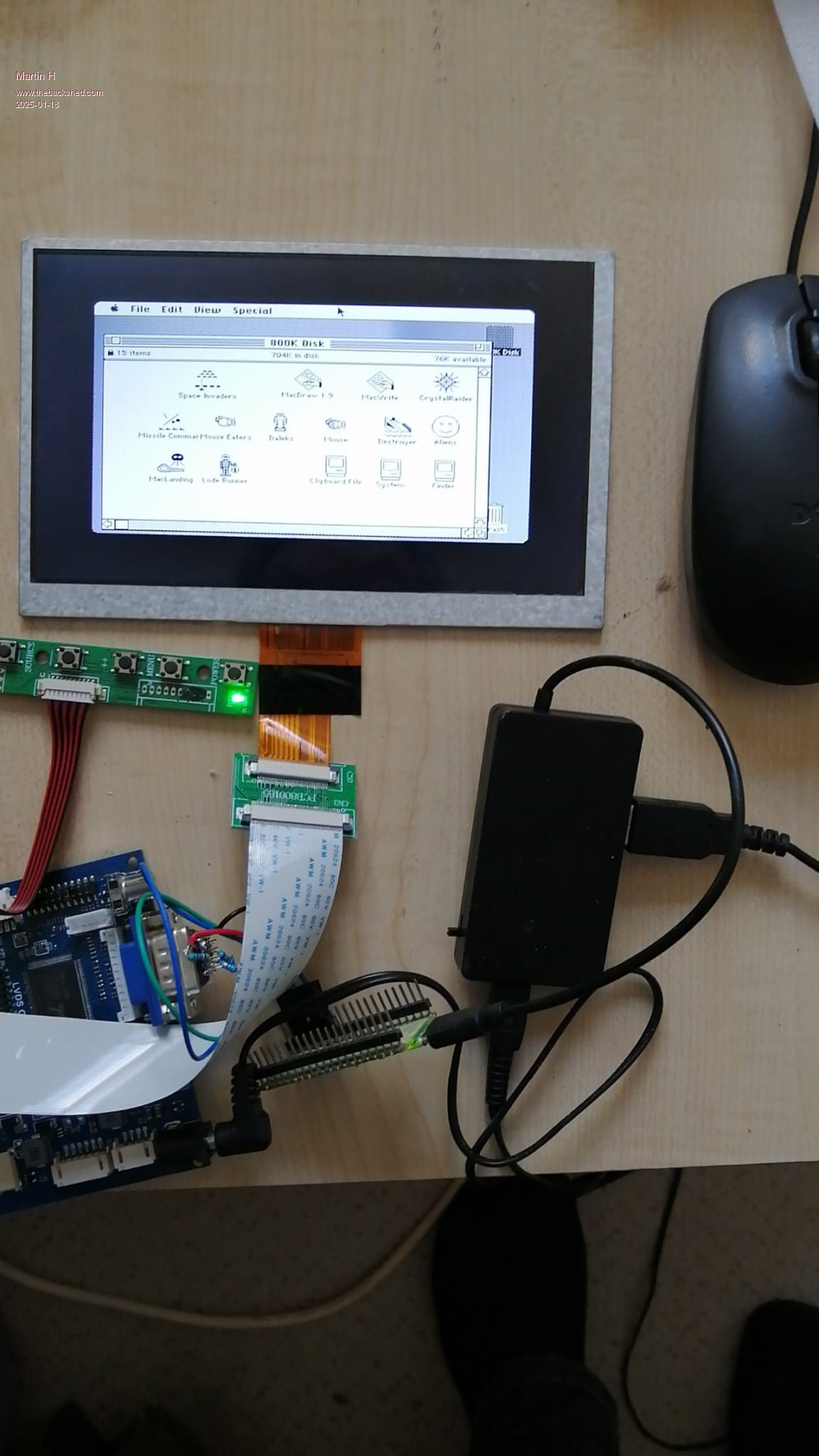

Posted: 12:29pm 18 Jan 2025
a project for cold winter days
Flying wiring but it works.
Unfortunately I have not yet managed to enlarge the image section
'no comment
