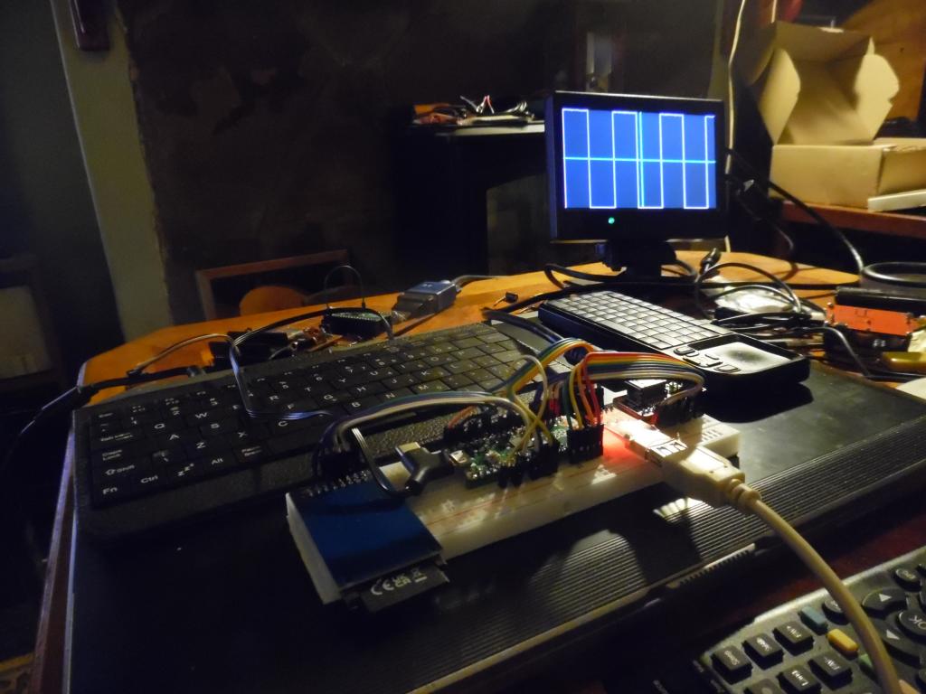

Posted: 06:24pm 24 Nov 2024
I don't know why I used gp26,gp27 for audio.
changed to gp0,gp1 as suggested in vga manual and all is fine in that it accepted audio gp0,gp1 and the gp28 as adc is working.
I got a vga usb board that runs this "scope" prog but no test pwm signal with hdmi usb

Are you sure your PWM output isn't working? If you set freq=50 you could probably measure something on it on the AC volts range of a multimeter.
Posts: 6582
Posted: 08:18pm 24 Nov 2024
You seem to be fixated on GP28.
Do you have GP2 linked to GP26?
GP26, not GP28.
adc open freq*100,1 'samples per second
ADC command uses GP26 as the first input and in this case the only input.
Posted: 08:52pm 24 Nov 2024
  TassyJim said  You seem to be fixated on GP28.
GP26, not GP28.
idiot I am connected gp2 to gp26 and I got pwm wave on screen
