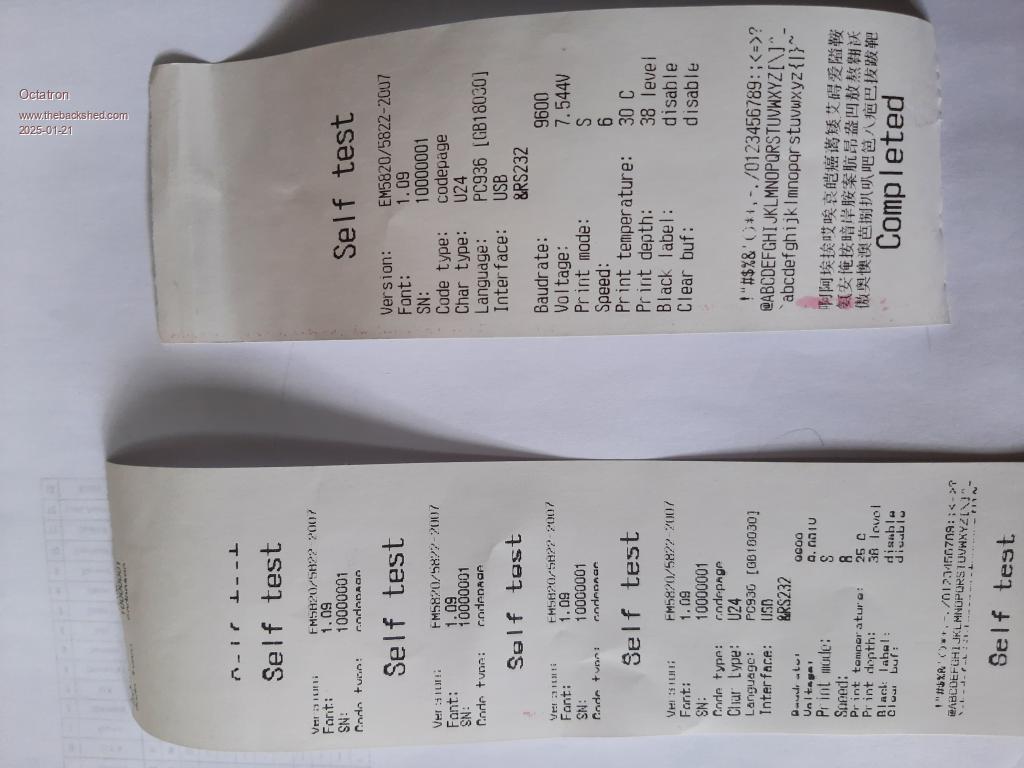

I've used these very printers on a couple of projects, and they are dead-easy to use and to write program code for.  If you want examples, let me know, but it looks like you might have selected another printer by the time I got to this thread.
There is also a little utility program you can run on your PC, that changes the default font that the printer uses, and the baud-rate if you don't want to use the default of 19k2.

There is a little utility that allows you to set the font that the printer uses by default, the baud-rate(if you don't like the default 19k2), and as far as printing bar-codes, I seem to recall they can do that also, but I have never done it myself.
It will all be in the commands you send to the printer over the UART.

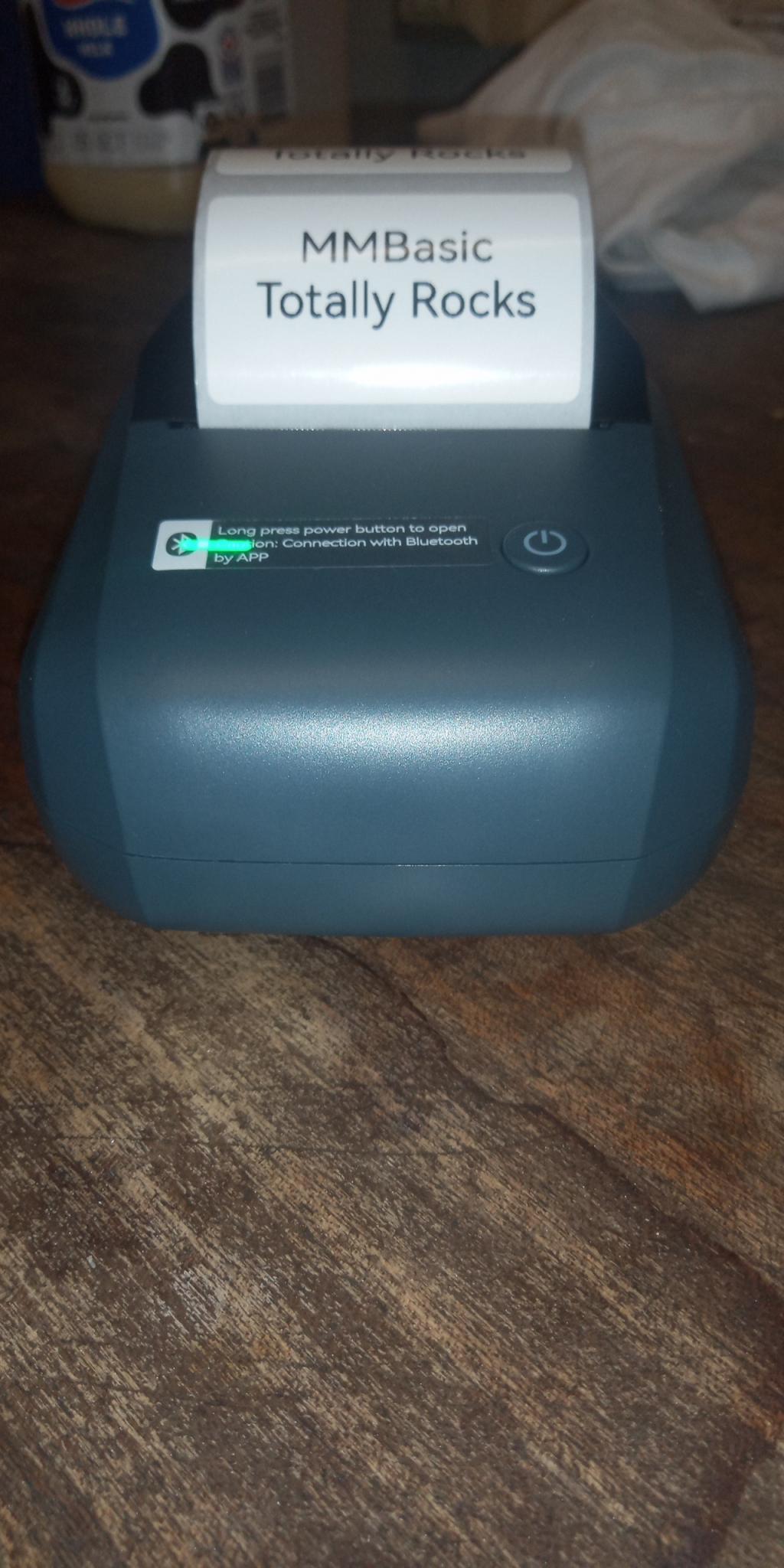

I ordered a Niimbot B1 (yes double I) and it just arrived.
Very cool. I need to ID lots of components in the control panel and this is just the "ticket"

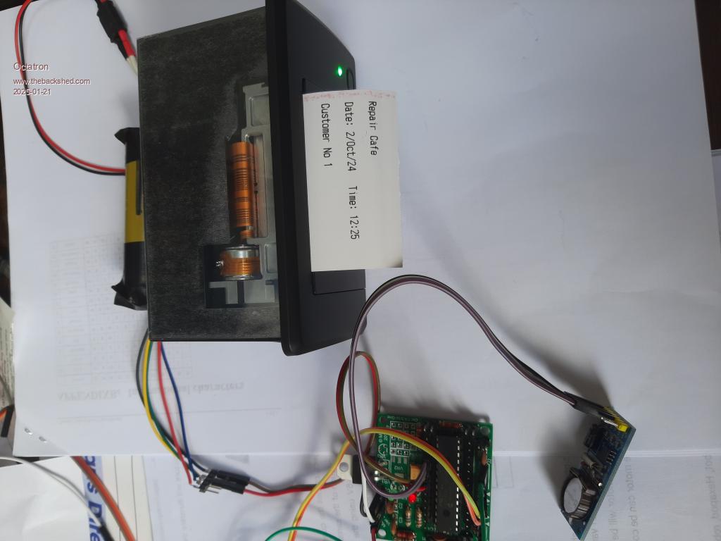

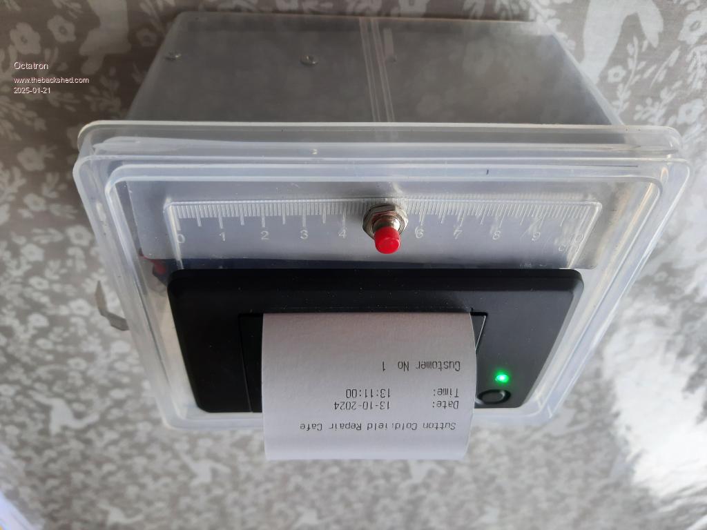

Posted: 05:22pm 20 Jan 2025

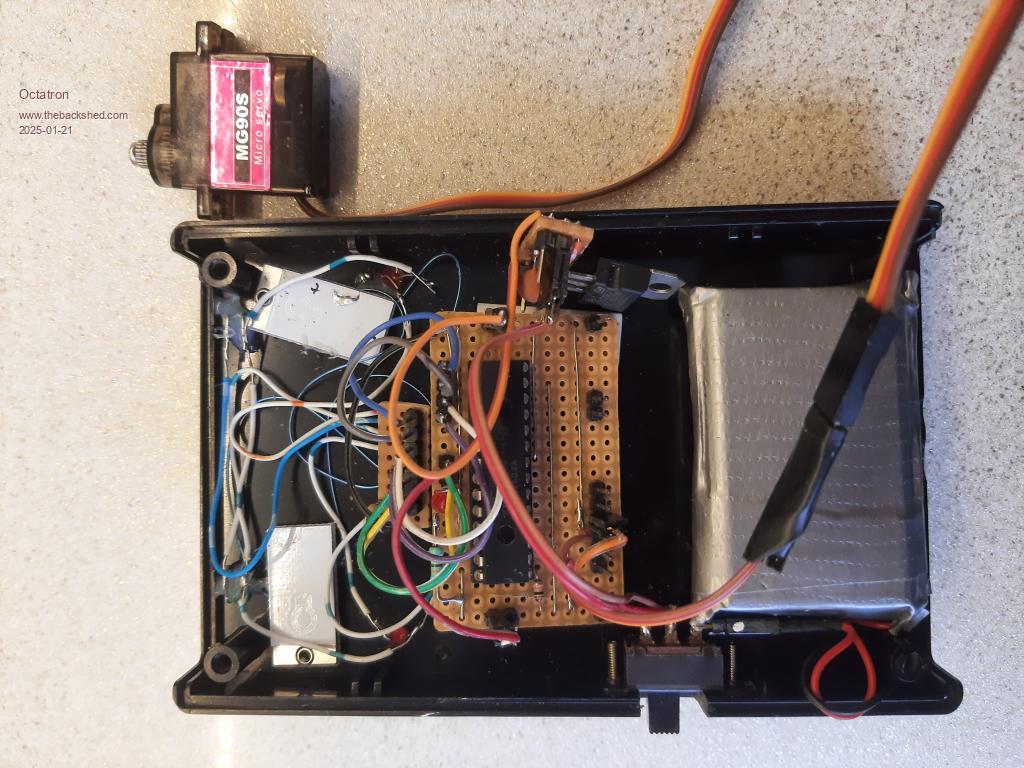

I thought I would give an update on my mini printer project. Which was slightly delayed by a flag waving backpack for a robot. I used PIC32MX150 that I had to hand built up on some veroboard and installed not very neatly in the backpack. A servo motor was used to wave the flag and there were also some LEDs to be flashed.
Anyway flag waving robot completed mini printer to focus on. The first thing I discovered was that my lab power supply at 0.5A max wasn't man enough to power the printer evidenced by not fully printing out the test print, LiPo batteries came to the rescue. I used again a PIC32MX150 on Mick's uMite PCB along with a RTC a few lines of code and the project was complete. Let me know if anyone needs more detail.
