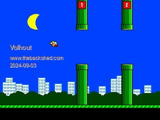

Posts: 6198
Posted: 10:43am 03 Sep 2024
  thwill said  Thanks Phil, but SAVE IMAGE always saves in the 24-bit true colour .bmp format.
Sorry Tom, not true.
If you show an image in mode2 on a PicoMiteVGA, and SAVE IMAGE, you get a BMP files that is 38kbyte size. This is 4bpp.
If you SAVE COMPRESSED IMAGE, you get a BMP file that is (depending the content) few kB...40kB in size. Also in 4bpp.
I use this function, to convert a 24bpp BMP file (created in any package) to a smaller size 4bpp BMP file (like for PETSCII robots). A 320x240 24bpp BMP file is 250kbyte in size.
This is different from LCD. The LCD version saves in 24bpp. Maybe this difference should be added to the PicoMiteVGA user manual, since it is quite essential.
4bpp imgae, and compressed 4bpp image.
flappy.zip
This is the type of image in the zip
Edited 2024-09-03 21:10 by Volhout
4bpp image, and compressed 4bpp image.
flappy.zip
