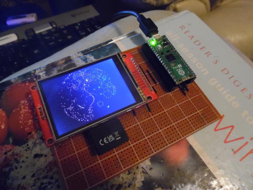

I never got github to work.build stuff?
I dropped a pico2 into a 2040 picomite ili9341 and it seems visually faster.
Connected to COM20 at 115200
> option list
PicoMite MMBasic Version 6.00.00b3
OPTION AUTORUN  ON
OPTION FLASH SIZE 4194304
OPTION CPUSPEED  378000 'KHz
OPTION LCDPANEL ILI9341, LANDSCAPE,GP15,GP14,GP13
OPTION TOUCH GP12,GP11
GUI CALIBRATE 0, 3919, 3854, -899, -662
OPTION SDCARD GP22
it's really nice, ta mr. math again. not a priority, dvi
