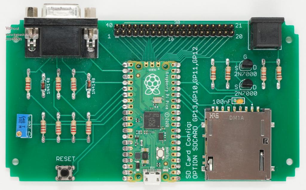

hi stuarts,
Are you sure you have programmed the VGA version of the software.
There is also a PicoMiteV5.08.00 microcontroller software version, that does not have VGA output or a PS2 keyboard input.
Check for the file that has "VGA" in the name.
The SC board is what Geoff calls "Design #1", the details are here.
Design #1.zip
It complies with the default VGA pinout that PicoMiteVGA 5.08.00 has out of the box.
It also complies with the default SD card interface from Peter's VGA platforms.
So you should only need to set
OPTION SDCARD GP13,GP10,GP11,GP12
After installing the picomite software. And then everything should work (Keyboard, SD card, VGA). The SC unit does not have any audio circuit.
When this does not help, is there a blinking green LED (1 sec rate) on the PicoMiteVGA after programming ?

Another piece of advise (talking from experience)...
Check your soldering. The SC design is a kit. You did solder it yourself.
Especially if you soldered the Pico on the board without headers (surface mount the pico), there can be solder shorts or insufficient solder connections.
Or maybe a solder bridge between the 40 pin header pins.
Edited 2024-08-30 20:53 by Volhout

Speaking as an electronics manufacturing engineer, Volhout’s post made me cringe. There are 9 gold pads on the bottom side of the Pico, so please do NOT surface mount solder a Pico with circuits running under the Pico footprint. Looking at the picture, it just takes one tiny solder ball to connect one of more GPIO circuit to the SWDIO, GND or SWCLK, and you will loose too much hair trying to determine the fault.
If you insist on surface mount soldering  this board, do yourself a favor and cover the circuits with a piece of polyimide/Kapton tape before soldering the Pico.
