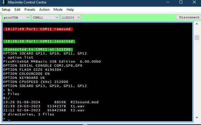

Posted: 05:50pm 28 Aug 2024
I just soldered headers to pico2 and testing
I swapped usbvga 2040 with pico2 usbvga and it reads sd card reader.
usb keyboard doesn't respond though. it has usb c and micro usb and 2040 had usb c but pico2 is micro.try different usb full size kb tomorrow.
asteroids works as does bubble universe. just testing as requested :)

I know the RP2350 will drive a micro SD card as I've done it on a Pico 2. I was playing WAV files from one last night.
With a micro SD card you wouldn't normally need a cap bigger than 1uF. I'm running it without one at all. I had to fit the series resistor because I'd left a space for it on the PCB so it wouldn't work without. :)
Try not setting up System SPI. Use the four arguments for SDCARD.
If you want the RTC (which also works on the Pico 2) you'll need System I2C.

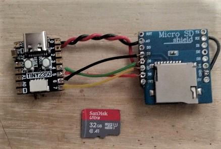

zeitfest
Joined: 31/07/2019
Posts: 702
Posted: 07:26am 08 Sep 2024
"Tiny" RP2350 with SD micro hanging on.
Not elegant but it works ok for a trial.    Took some time sorting out the SD !! It is running my interpreter programs from the card, driving I2C display etc so it is OK.
[ not MMBasic ]
