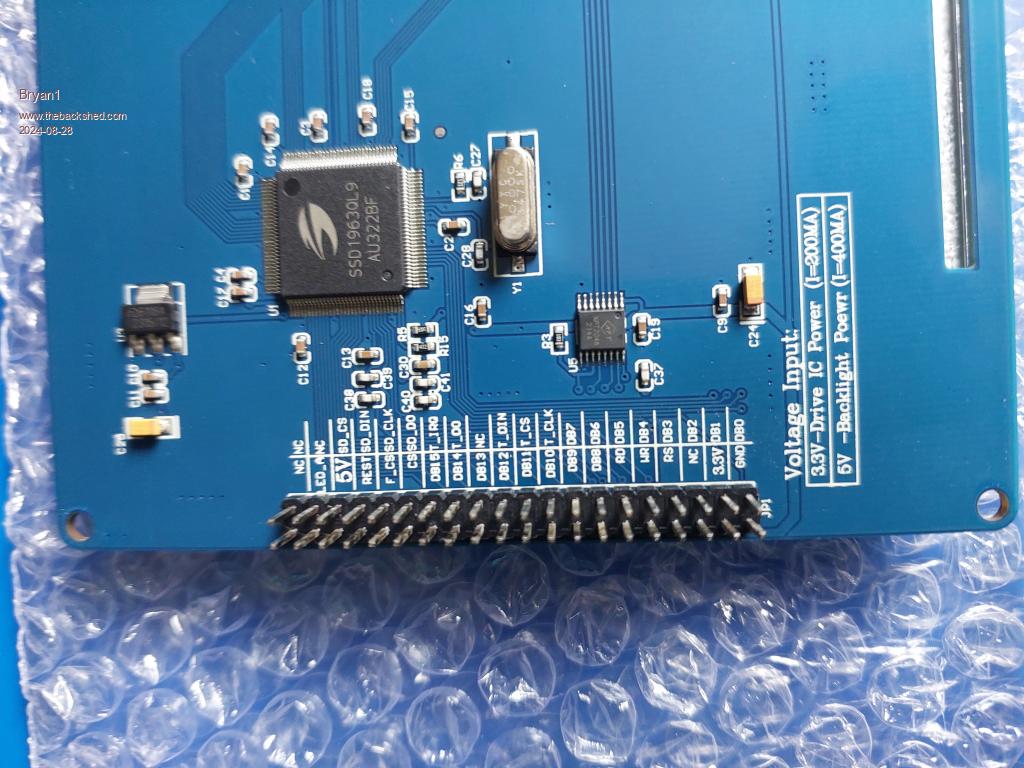

           Well I bought this and it clearly stated SPI or do I have it wrong that these size displays do need a 16 bit connection.
Anyway got 5 standard picos on the way as the zero doesn't have all the pins to run this.
Regards Bryan

The SPI would be referring to the touch interface. They can be run with 8 bit parallel, the Picomite manual gives the wiring. The pins for D0-D7 are fixed, but   you can be flexible with RD,WR,RS and Reset pins

More AE inaccuracy, I'm afraid. :)
They are a very nice display though, even if you need a lot of GPIO pins. Faster than SPI displays by quite a bit.
