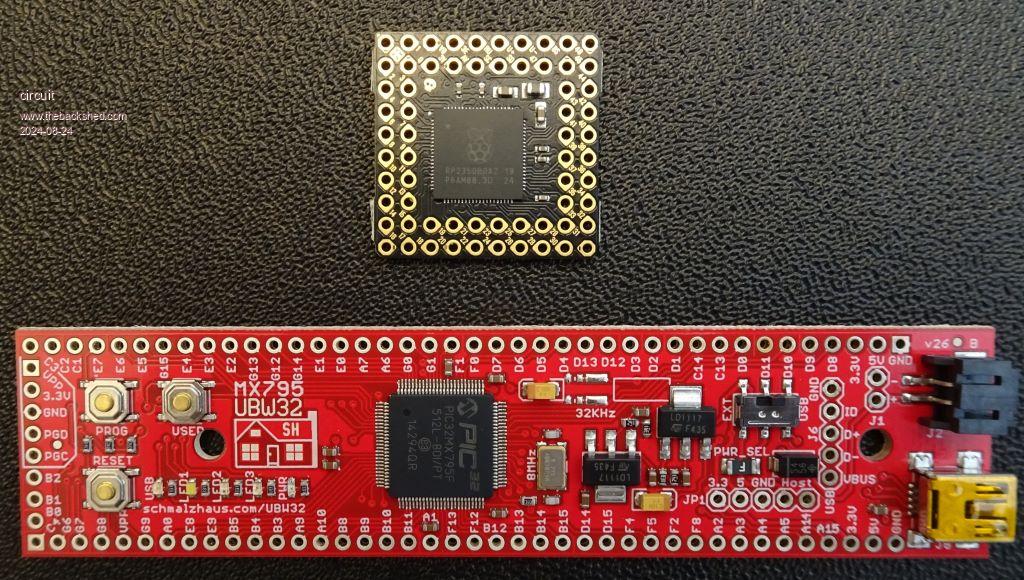

The only current embodiment of the 64pin version that I can find is the Pimoroni PGA2350; a board that I find rather absurd.  It is hardly a development friendly outline.  What I would really welcome (and I assume would any others who work with stripboards and breadboards in their development projects) would be an RP2350B mounted on a straightforward long board with 32 pins on each side in the manner of the now obsolete MX795 board by Sparkfun.  I have several of the Sparkfun boards and, despite the version of MMBasic for the board having had no development for several years, I find the layout so compelling that I continue to use them from time to time.
The picture below shows a Pimoroni PGA2350 board next to the MX795 board; given a choice, which format would YOU prefer to play with?
So here is a call to manufacturers or to those with contact to them, perhaps Sparkfun or Pimoroni, to mount up an RP2350 on a board in the format of the MX795 (UBW32) board.  I am sure that this would sell rather well! (I would be first in the queue.)

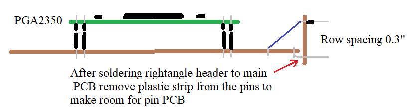

Posts: 3361
Posted: 05:18am 25 Aug 2024
A breadboard adapter for the PGA2350.
Could be a PCB or stripboard with a lot of wire links.
It should work well with Jim's layout above by extending the wires from the second header strip to the opposite end of the board.
Edited 2024-08-25 15:26 by phil99
