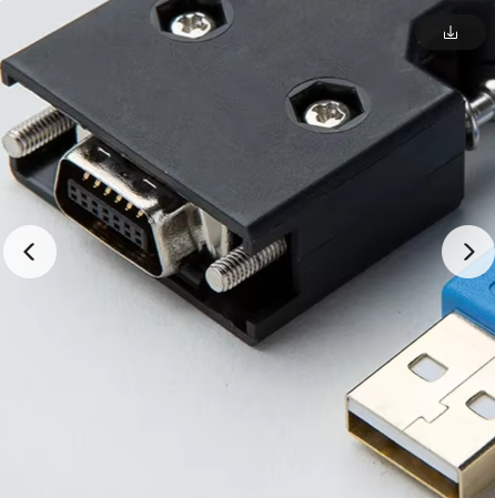

Just hit my pet-peeve roadblock with one of these Yaskawa drives. I need to disable the internal control-loops because the PicoMite will be handling the PID, etc.
There is a small control panel on the front of the drive with buttons and seven-segment display but the display disappears after a couple of seconds. Ah-ha, I can connect serially which is actually easier and I have the programming software. It requires a USB to serial cable of which I have many....BUT...
Naturally....I need a special cable
So sick of these games that these big manufacturers play...OK they charge stupid money for the cable but for the end-user? Yeah it takes a week to get one.
"Sorry employees, we need to shut the doors for a week and we might lose the contract"

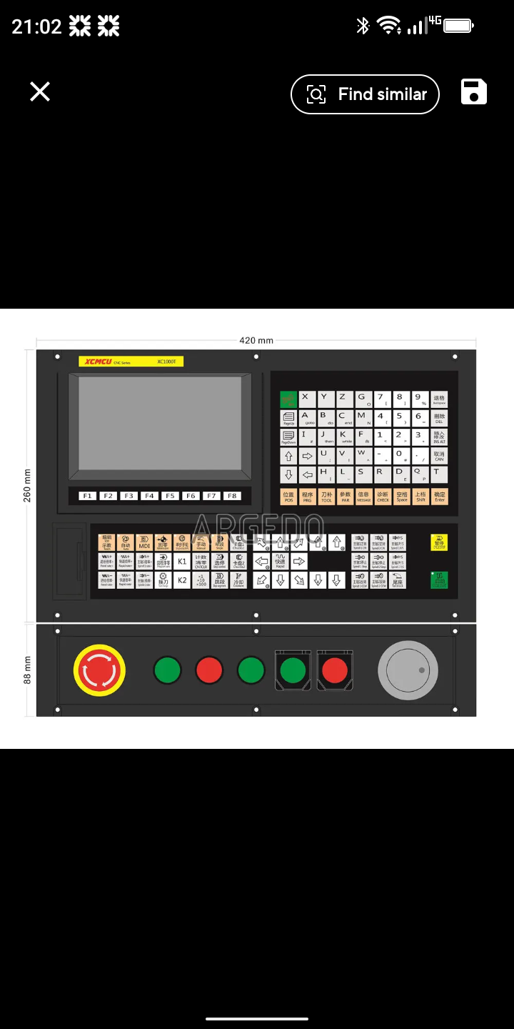

This is one example of a fully capable CNC control but no good by itself because it only outputs pulse/dir.
To retrofit an existing servo controlled machining centre, new drives and motors are also required and important capabilities are lost.
The PicoMite will convert to the industry standard +-10v motor command and will also allow the user to retain such things as acceleration and velocity feed forwards, torque limiting etc.
The Mach3 and Mach4 guys will go for this also
Don't know what happened to the image (on my phone)
