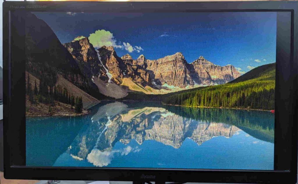

3: Increase to 250K to give 640x400x8bits with no significant increase in program size. In this case 640x400x8 would be a new mode 2

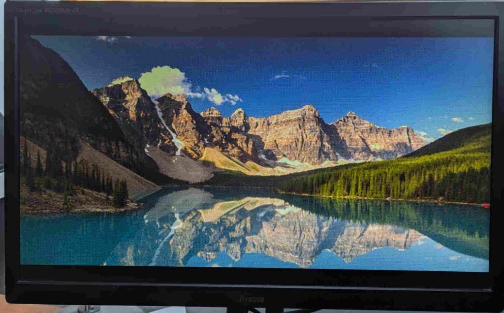

4: Increase to 218K to give 640x350x8bits with no significant increase in program size. In this case 640x350x8 would be a new mode 2
I quite like the 3 option as certainly on my 1080p monitor 640x400 automatically scales to full height and near full width
Option 4 also works well on my monitor. The aspect ratio is just greater than 1080p so there is a gap top and bottom but the width is filled and it does allow for a small increase in program size.

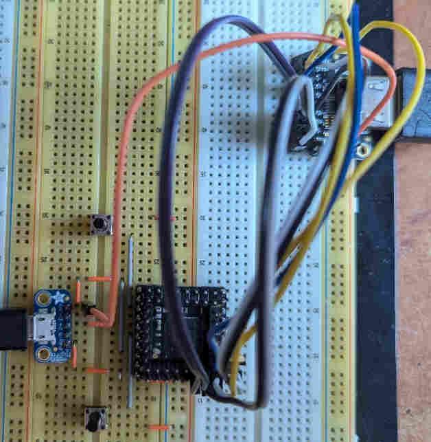

Both these images are created by a RP2350 in HDMI with all the HDMI code running on the second processor like the VGA RP2040 version
The image quality and stability is remarkably good considering the flying Dupont leads. Thoughts and other suggestions for memory use appreciated.

For photos I prefer option 3 judging by your pics. I suspect it would look better on most monitors. Option 4 might look very small on a 4:3 display.
