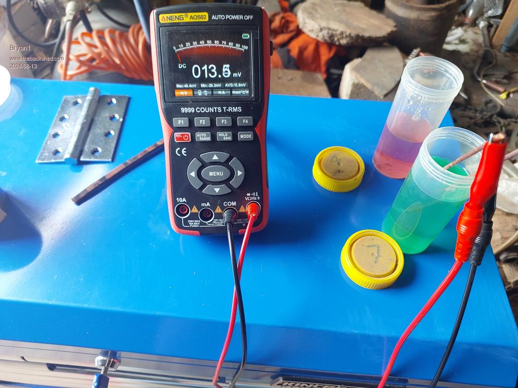

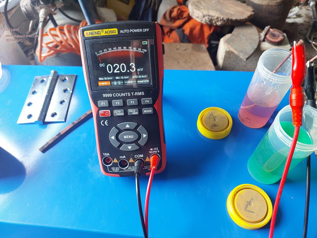

Ok coated some 2.8mm wire and put the probes in some PH4 buffer
Then some PH7 buffer
Now it did take a minute or so for the voltage to stabilize so the first rough trial is getting there.
Cheers Bryan

Posts: 3417
Posted: 06:10am 13 Aug 2024
What you are plating that electrode with is pure silver. The silver that is coming out of the solution is being replaced by copper being eaten from the other electrode. The solution will now be a mix of silver chloride and copper chloride, which may turn the solution blue or green as the amount of copper rises.

  phil99 said  What you are plating that electrode with is pure silver. The silver that is coming out of the solution is being replaced by copper being eaten from the other electrode. The solution will now be a mix of silver chloride and copper chloride, which may turn the solution blue or green as the amount of copper rises.
Yep the solution did go from green to blue so decided to clean up the probes and have another go with the 4 and 7PH buffers and got a total different reading where PH 4 was stable around 4mV and the 7PH was -10MV now looking at the mV range of a PH probe this is way off.
So next trial will be rubbing on this horosilv with a damp rag to some thin brass plate as thats how it reads to apply the stuff. Then cut the probes to size and see how it goes.

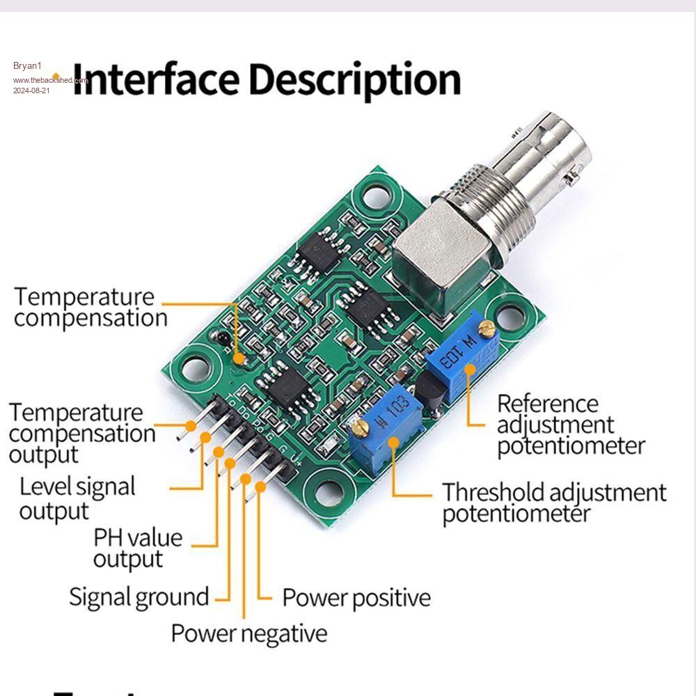

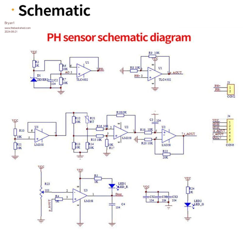

           Well finally got some info on this PH sensor and here is the schematic for the sensor board.
Now here another pic showing the connection setup.
Just checked the tracking and it's still a week away but now got some info to work with.
Regards Bryan

There are standard ic's for this task eg
this  which is worth a read
