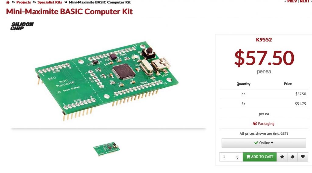

 Silicon Chip Mini-Maximite Basic Computer Kit

You asked about this on 7th August and I don't think things have changed much over the last few days. :)
That's a very expensive board for what it is. Isn't it the old mono Maximite 1 but stripped down and in a smaller package?
The clock is 80MHz A non-overclocked Pico is 133MHz and you can go a lot faster than that.
Then you have the PIO on the Pico... It's designed for high speed stuff.

@ mixtel90 I wan't asking about the Mini Maximize I was Pointing it as a picomite MMBasic Alternative if the Pico wasn't fast enough to use as a Spindle Tach and control the Speed Controller. Ultimately I'm looking at building it modularly with 1 Master Pico that is the User Interface, and modules for Speed control and Stepper I want to make all Cheep Pico 1s and I don't need color for the display

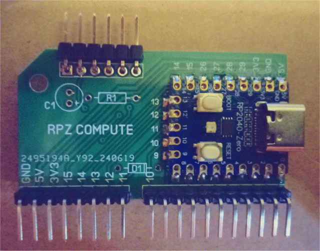

  Rickard5 said  I'm looking at building it modularly with 1 Master Pico that is the User Interface, and modules for Speed control and Stepper
You mean you basically want Mick's RPZ system with additional modules (if actually needed)?
Mick's RPZ Compute

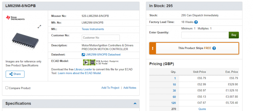

A very common dedicated motion chip is the LM628/629. The PicoMite blows it out of the water....look at what it costs:
