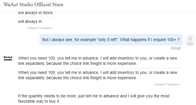

I have the Nucleo H743ZI2 but I also have several of the more compact, 100-pin WeAct modules.
On AliExpress, WeAct was only ever showing a limited availability and so I contacted them regarding future supplies:

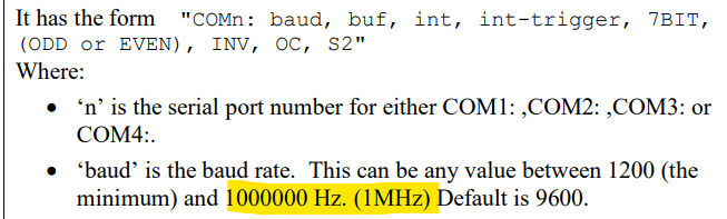

I don't know if I have somehow missed the latest manual but mine still shows:
I have tested to 3MBAUD...The H7 won't recognize anything faster.
