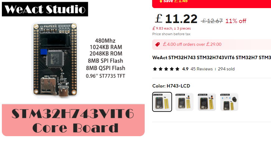

Not sure what you're looking for but the ARMmite H7 can handle 800 X 480 @ 16bits
Awesome device

I don't think it's much competition for the PicoMite at that price!

  Quote  I don't think it's much competition for the PicoMite at that price!
3X as fast as a fully overclocked PicoMite, 4x RAM, much more I/O, vastly faster display output - no comparison
Edited 2024-08-07 17:19 by matherp

My reply was about the Mini-Maximite, Peter. I don't know what happened to the order of the posts. :)

Posted: 11:56am 07 Aug 2024
  Rickard5 said  OK you had me at more I/O
But I think matherp was talking about the H7, not what you originally posted about or the E64.
