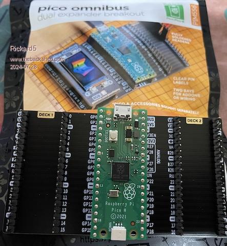

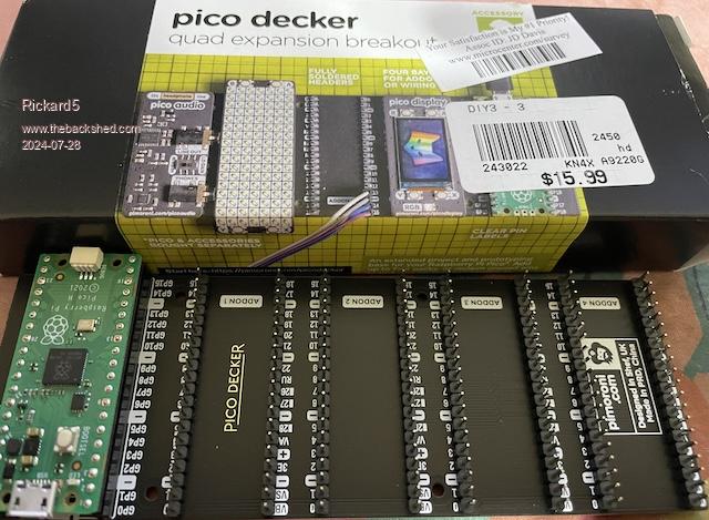

I Apologize in advance for the coming Word Salad, no one Ordered. But the thoughts and disbelief are coming 100 mph in Random order! I'm  such disbelief Pimoroni the Premier Raspberry Pi 3rd Party Supplier would sell such Unintelligent stuff! I'm so on the edge of spending Large $$$$ to call the UK to tell then What I think of The Quad Expander
and the Pico Omnibus
I bought 2 of each the other day and just had time today to play with them, and my issue is if you look at them, if you plug the Pico in to the slot for the pico, all the pins one the right are on the left side of the expansion slots and left side pins are on the right side of the expansion slots. so if you build or have a Hat to add, you have to add it upside down to get the pins correct and why the boards only have Male pins and not female socks confuses me more! this is Hurting my Brain so bad AM I STUPID OR SOMETHING ? I Swear from my lips to God's ears I Haven't been on Jack Danials in years, but I'm ready for a bottle or 2 tonight!

the only Female sockets are the location for 1 Pico per board, I'm not Beating my self up but I am just God Smacked at such Bad design!
Probably the Greatest Designer Ever to live Dieter Rams Gave us Design Rules and the most important of them is "Good design is making something intelligible and memorable. Great design is making something memorable and meaningful." poor design is Pimoroni

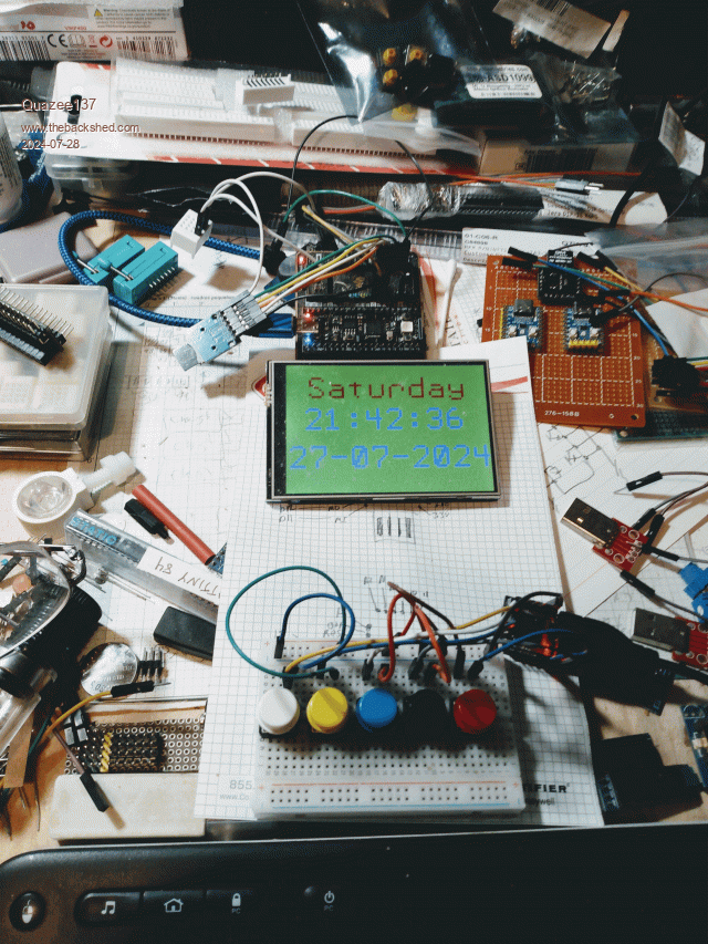

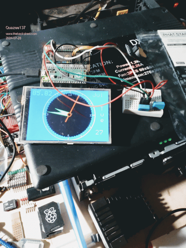

I use the Pico to Hat with the PHAT STACK. Earlier projects used the MM170
hat stand and PHAT STACK.
Here is two of the Pico to Hat setups
WIP is a Pico stamp to hat to replace my old MM170 when the need to be replaced.
Easier to make use of the stamp but better would be Pico Hat Stand.
Having FUN
Quazee137
side note: I could not upload jpg or png had to convert to gif
Edited 2024-07-28 16:28 by Quazee137

If you think of it, how do you fit an add-on module onto a Pico? The Pico has male pins so the modules must have female sockets.
And so...
Each board has one set of female sockets to plug a Pico with male pins into.
Each board has two or more sets of male pins to accept a normal Pico add-on module.
All the pins are in parallel with each other. It's just like stacking add-on modules onto the back of a Pico. It's exactly correct. :) There's no point in having male pins on an add-on module. A Pico couldn't plug into it.

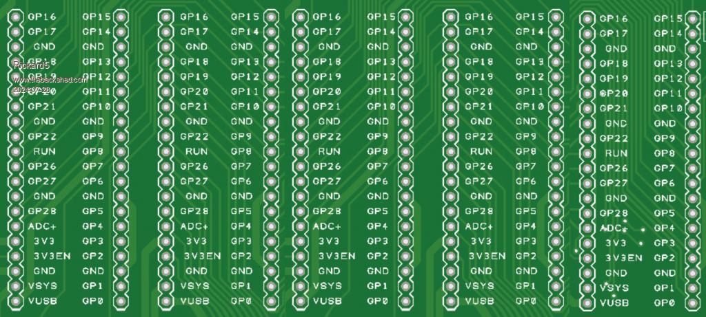

Mixtel90 your good at whipping out boards real quick.
How about an experimenter board using female long pin headers and an
array of pads give 2 connected pads for 1 header and 1 for hookup use.
     LOOKING AT TOP
VBUS   o-o o o o o o-o   GP0
VSYS   o-o o o o o o-o   GP1
GND    o-o o o o o o-o   GND
3EN     o-o o o o o o-o   GP3
VREF   o-o o o o o o-o   GP4
GP28   o-o o o o o o-o   GP5
GP17   o-o o o o o o-o   GP14
GP16   o-o o o o o o-o   GP15
could also be used on the pico for DIY use making things smaller.
Just random thoughts tonight LOL

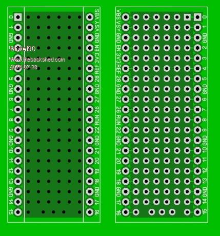

Or is it this? If so, I rather like it. :)
I based it on the YD-RP2040, which is slightly larger, to fit the text on.
EDIT:
I've just looked at the JLCPCB pricing.
Putting four of these to a board, with them panelised, they've estimated a price of £5.28 + shipping for five boards. That seems pretty good for 20 modules.
Edited 2024-07-28 18:33 by Mixtel90

Mixtel90    I knew you would have this out faster than I could.
 Looks GREAT now one can easily add spi, I2C and other connectors to
  the base pico back side. no need to do up a pcb for limited projects.
  Also should be stack able using the female long pin headers.
Thanks making the idea real.

Here's the gerbers that I got priced. They are for four units to a board.
You need to select "panel by customer", 4 columns, 1 row. I also went for a slightly thinner board.
pbgerber.zip
