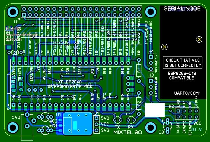

This isn't specifically a MMBasic platform, but it could be used as such. It could just as easily run python. Basically it's a Pico (or clone) attached to a ESP8266-01S socket. The GPIO port can get it's 3V3 supply from the Pico or from an on-board regulator, which can also power the ESP socket. I called it a Serial Node because I think its main use would be as a distributed IO system, using wired or wireless networking.
The system bears an uncanny resemblance to a Raspberry Pi for some reason. :) It will probably accept the same "hats" mechanically but you need to sort out your own software support. The GPIO pins are functionally the same in most cases.
The ESP socket can be used with the ESP8266-01S or with any of a range of adapter boards for other serial devices. If the board is used stand-alone there is an option to fit a microSD socket in this position.
If you have a CMM2 fitted with a ESP8266-01S then this would make an interesting remote IO module for it.
Once again, I'll sort out gerbers etc. if people are interested.

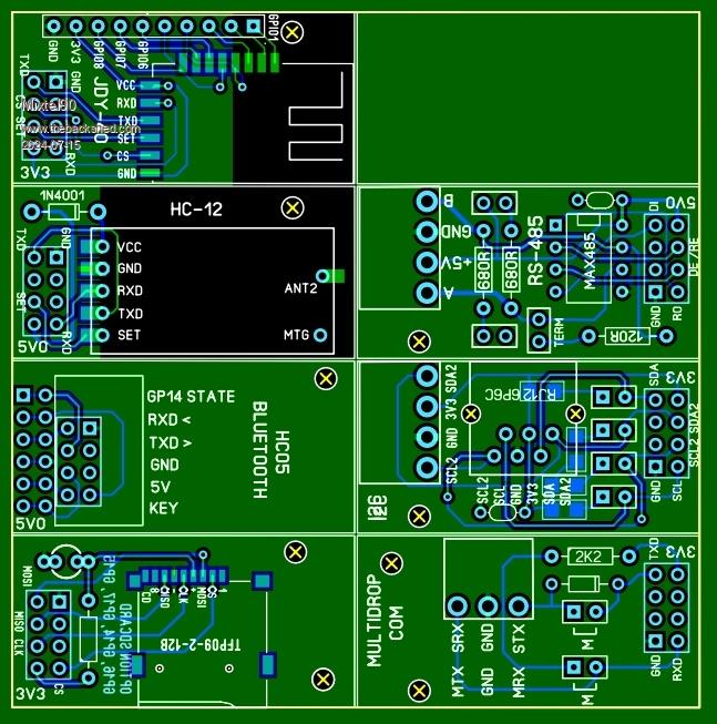

I've changed the JDY-40 and HC-12 to make them the same size as the others.
The HC-12 will now take the module surface mounted.
The JDY-40 has moved to the top of the adapter and has a 10-pin connector to bring its parallel port out.
There is now a multidrop COM module that can be master or slave.
There is now a I2C module with I2C2 on terminals and both I2C ports on a RJ-12 socket to match the Pineapple Pi. There are links for all pullups.
A set of adapter modules now fits nicely on their own board and there is one spare position in case I think of something else. IR maybe? Suggestions?
The VS1053 is proving to be a little bit of a pain as I'm now eating into the pins a bit. I was trying to keep the ADC pins all free if possible. We'll see...

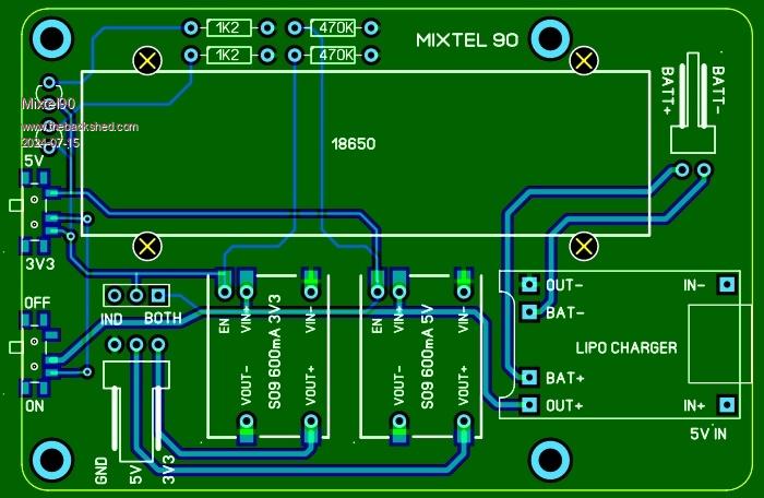

How do you fancy a "power base" with a 18650, charger and buck-boost converter? It could be direct to 3V3 for maximum efficiency, but that would limit the available adapter boards. A 5V would work but then you have the additional LDO producing waste heat for no reason.

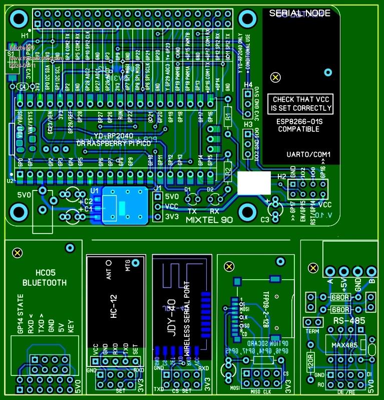

And so it progresses. Some tweaking, some fixes and some new stuff.
You can now start with just the serial node then add other bits as you need them.
Serial Node
Power Supply

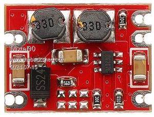

This is new. It can output 600mA in 3.3V, 5V or both simultaneously. Different output pins are used so that you can't accidentally connect the wrong voltage (if your lead is correct). The DC/DC buck-boost converters are very cheap from AE, as are the little slide switches.
These are available in several other voltages.
Adapters
Some re-sizing for conformity. Some tweaking too. The one I can't add is nRF24L01 as the pins used don't form a SPI channel.
Computer

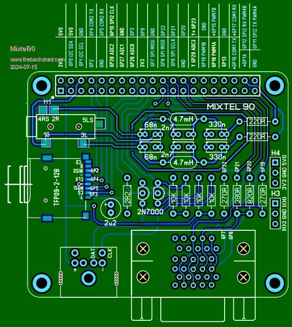

Another new one. This is a PicoMite VGA without the PicoMite. :)  The pins have been moved around a bit as I wanted two of the audio pins to also be available as SPI for a VS1053. I've not sorted that out yet.
I think these are probably the final design versions, apart from sorting out some text. There are no circuit diagrams or gerbers yet.

Final version of the power supply.
This might be useful for several projects as it's a directly stackable power bank that's mechanically compatible with any Raspberry Pi boards.
It can also be used as a fairly general purpose supply as the output can be switched between two different voltages. The output is 0.6A, which is enough for a lot of things, and as it's from a buck-boost converter it's short circuit protected.
The battery is one or two 18650 cells.
PSU construction pack.zip
It's quite possible to make the output voltage variable within limits using a pot. Be careful though as it's also quite possible to mess the feedback network up. :) The fixed resistor version noted in the manual works well.
The little switches I used came from AE and are *tiny*! Fit and test them first.
