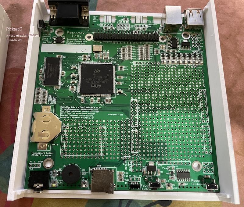

I was Reading another CMM2 post and there were Port Maps (I don't know the proper name) for CMM2s that look nothing like the 2 I have, I love my CMMs so much I'm scared to fiddle with GPIO Port. That's why I love the Picomites worst thing I can do is blow up $2  that I have 150 of them. My CMMs have the PIN numbers labeled but not defined, how can I find the right pin definition for each one?
Posts: 9081
Posted: 09:07pm 10 Jul 2024
It's very much like the PicoMite but the pin numbers are different - you use SETPIN to configure what you want a pin to do. The various options are shown in the manual.
The layout of the GPIO port is also shown in the manual (get the right one for your CMM2 version). AFAIK the RetroMax will follow the same layout, but you will need the manual for that to be sure. The diagram shows what you can configure pins for, but they can be standard digital IO pins.

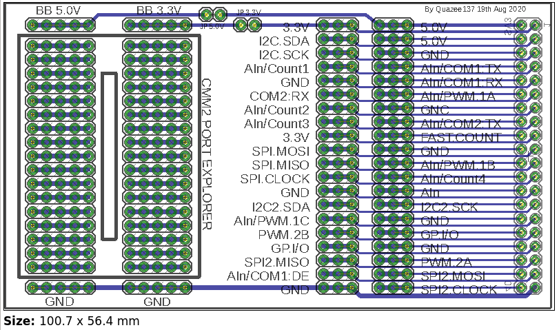

Rickard5
A while back I made this for a school TBS
I have more if you want one. I think I may have the full kits.

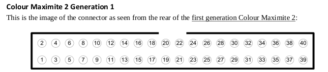

Hi Quazee137,
For what version of the CMM2 are these. I seem to remeber that the original connector (on the CMM2G1) was upside down. And that was changed at the CMM2G2. And if recall right, the latest incarnation CMM2G2V2 is back to G1 pinout.
I guess this is made in the high days of the CMM2, so for the G1..??
Edited 2024-07-11 20:45 by Volhout
Quazee137
Joined: 07/08/2016
Posts: 603
Posted: 12:30pm 12 Jul 2024
Volhout Yes it is for CMM2G1. I also used it on a RPi Zero
