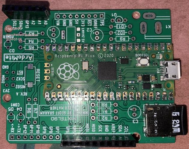

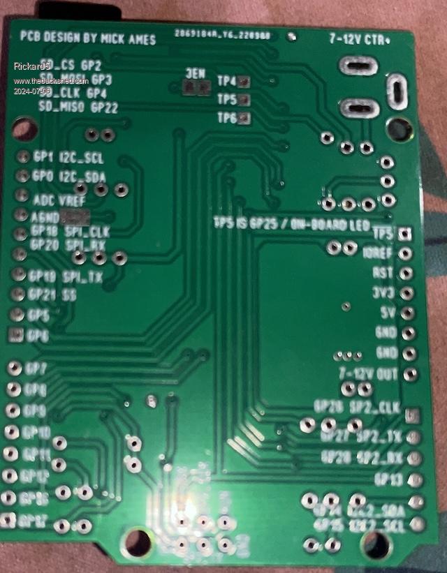

Way back when before I took some time off You had designed some Arduino form factor Picomites.  I built one today, and I can't. find any of the info or notes is can you tell me What the option sdcard string is ? and can you tell me the value of C3 and what it is ? and the rest of the BOM I would like to Build as complete one, and explore the designers full intentions

  Manual said  Where no other devices share the SPI bus the SD Card can be set up with:
OPTION SDCARD CSpin, CLKpin, MOSIpin, MISOpin
So from your top pic:-
OPTION SDCARD gp2, gp4, gp3, gp22
However I wonder if that is a misprint, that sequence is unusual. I would have expected:-  OPTION SDCARD gp22, gp2, gp3, gp4
Edit. Not a misprint. Found the circuit in the Construction pack.zip here

I don't usually make any special effort to choose pins for the SD card unless I am already specifying system SPI. There's no point as it doesn't need a hardware SPI module in the RP2040. I just make the connections where they work out easiest. :)

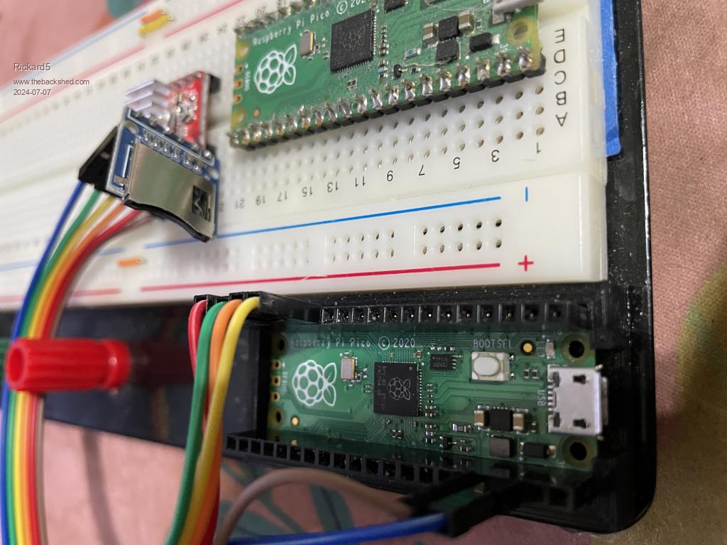

Well I'm doing something Wrong somewhere Every Picomite board I've built I can't get the SD Card to work unless I Hotwire the SD Card socket strait to pins. I have no idea what I'm doing wrong, I've been checking solder joints under microscope and I've even washed boards for 12-14 hopped in ultrasonic to get of flux. I have 4 more of these Arduino boards I'm gonna try. is there any passives I'm missing or do I only need the socket and the Pico?

If the SD card works on the breadboard but not on the PCB then you have a PCB track problem. You will have to test every track to the SD card socket with a meter - even a microscope is no use as breaks can be extremely small and the gap filled with solder resist. You will also have to test for short circuits between adjacent pins in that area of the Pico.
If you haven't got a meter (you haven't confirmed or denied that yet) then there is another way. Without setting OPTION SDCARD (and without one plugged in) set all the pins donnected to the SD card to  digital inputs. Then , for each in turn, watch the pin in MMBasic while you connect the SD card end to 3V3 and GND. You should see each one change.
Your original problem was with the Type 1 VGA PCB, wasn't it? Are you now having problems with my Arduino-style design too? Are you sure you are using the correct MMBasic commands to use the SD card in both cases? The ArdoMite pcb looks right, the Type 1 VGA pcb is known to work properly. They use different SD card sockets, so it's not something that's common to those. It's possible, of course, that every SD card that you've tried is faulty, but it's unlikely.

Hello everybody
When I Hotwire the sockets in I'm using,
option SDCARD GP13, GP10, GP11, GP12
PIN
34 3.3V
10. MISO
15  CLK
16  MSOI
17  CS
38 GND
And like I Say it's working Good when I Hotwire them right to the BUS, but the onboard Solder on ones are giving me Fit's. I've ordered new regular and micro sd sockets from amazon, My Goal right now is to build up everything I can with with what I got and start ordering PCBs for what I Missed and get building

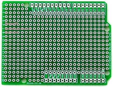

I must Take some or all responsibility I really did and do want a Mechanically compatible because of all the robotic Kits and other Projects that can be 3D Printed and the cool thing is the ready Protoboards availability !

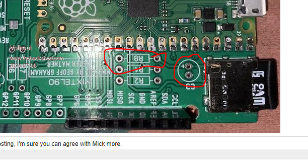

@Rickard,
You need R8 and C3 for the SD card to work.

@ Volholt
Last night I populated this board with what I had including the components you pointed ou snd still NO JOY, when I get back this afternoon I'm going to start all over and try again with a new PCB and Pico :)
