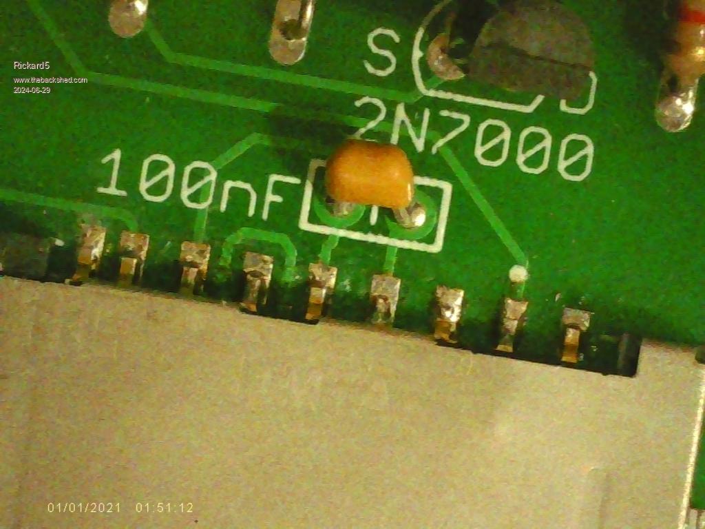

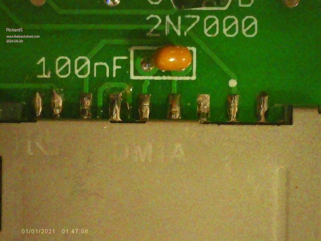

I've re-flashed all board and No joy Tried to Change to B: from prompt and I get the same results below is pictures of the solder job on 2 of the boards and I've checked all other solder joint under micro scope too

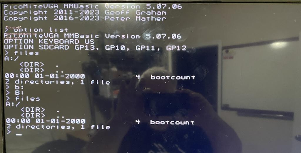

I've refreshed all 3 picomite VGA boards I finished and am now using a 2 gig microSD Card in an Adaptor. please excuse the bad screen capture but this is what I get from all 3 boards  Please excuse the LOW TEK Screen Capture
Thank You
Posts: 9246
Posted: 07:41am 30 Jun 2024
How is your card formatted? If you do it on Windows the default format may be wrong. It won't work with NTFS.
Your options are correct for that board and we know that the board design is ok so it must be something else. We need to check for bad etches and bad connections.
With the card removed and the power off, preferably with the Pico unplugged, check for shorts and/or open circuit connections from the Pico socket to the SD card socket. Use a thin wire into the socket so that you are checking the soldered joints. It looks like the SD card isn't even attempting to be accessed.

Posts: 6198
Posted: 08:09am 01 Jul 2024
Rickard5,
To much solder may short out the pins to the metal. Your second photo shows potential candidates for these shorts. Can easilly be detected with a multimeter.
The first photo has a non-soldered pin (6'th from the left).
Posts: 9246
Posted: 08:18am 01 Jul 2024
It might be an idea to lift some of the solder off using fine solder wick. First, it will remove any excess solder, secondly the re-heating and pressure will help the remaining solder get between the contact and the trace to improve the contact. You can always put solder back if you need to. :)
