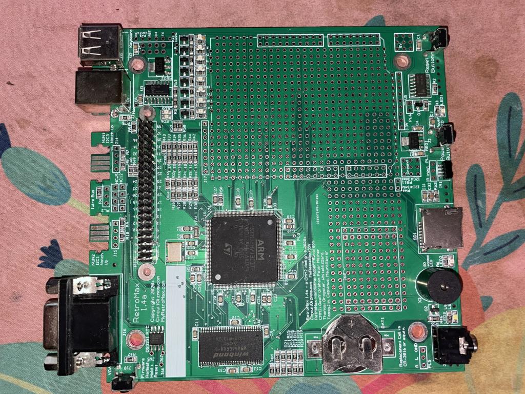

My RTC Batteries are dead in both my CMMs, I took a break from Everything for a while and am trying to get back at it, anyway Neither battery has leaked yet,  so I Pulled Them! Any thoughts on playing with them with our batteries?   Any thoughts about long term damage if I don't replace them?

Based on the board marking, these were made by www.circuitgizmos.com

It'll almost certainly be fine without the battery, however if you set the time and/or date it'll be lost as soon as you lose power. If there is anything in the RTC memory that will go too as it is battery-maintained CMOS.
I've never heard of any RTC that is damaged by not having a battery, no matter how long you use it for. After all, it's safe with a flat battery. :)

one more Question my power button its laid back like 30 degrees is this on purpose or have I damaged it? it still works, I'm just wondering if I should spend the $$$ to have one of the Rework girls to straighten it out?

2) The button should be 90°
