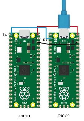

So to check what's happening I setup a simple system using 2 raspi PICOs as shown:
PICO#1's COM1 Tx line is connected to PICO#0's Rx line. The options on both are:

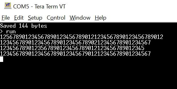

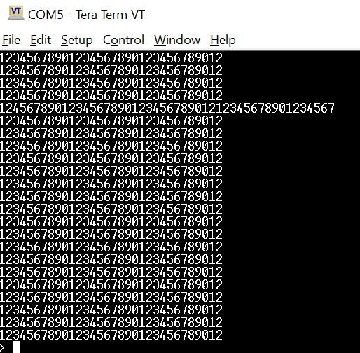

If I replace the PRINT statement in PICO#0 with
IF LEN(inp$)<>32 THEN PRINT inp$
I get lines printed roughly a minute or so apart as follows (ignore the first line since the program needs to sync first):
I've checked the serial line with a CRO and I can't see any change to the length of the data packet being sent by PICO#1 so I can only assume PICO#0 isn't keeping up with receiving data at that speed.

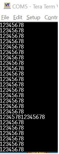

I just changed my test programs to send/receive 8 bytes and yep, same problem. Took a few minutes but it dropped the number '6' from the string:
How are you checking to see when your 8 bytes have been received? I assume you're reading the serial buffer using the INPUT$ command?
