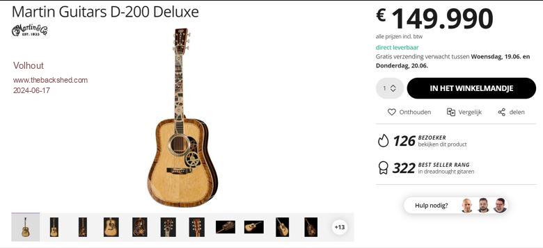

@Volhout
150K for a lump of wood with strings on it????
I'm definitely in the wrong business
I see a lot of £2,000 Martins at open-mic gigs and owners who can barely play.
They all have the aforementioned piezo pickups and sound thin and tinny but they seem to believe that they spent the money and therefore they must be sounding good.

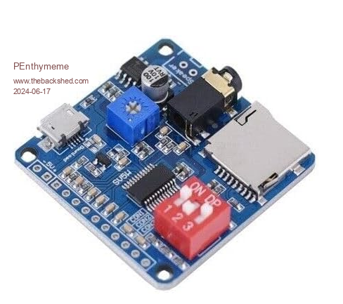

I bought one of these: https://www.amazon.co.uk/dp/B0CM47X42Q?psc=1&ref=ppx_yo2ov_dt_b_product_details
It has a few modes:
* It can trigger specific MP3s when pins are grounded (they way I use it)
* It can trigger specific MP3s and which part using UART mode
* (I think) it can also be controlled by SPI
PDF data sheet..
DY-SV5W Voice Playback Module Datasheet.pdf
My use case is a ghetto sound board linked to PicoMite.

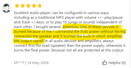

Surely not?
Posts: 9246
Posted: 03:15pm 17 Jun 2024
Unusual nowadays. There have been circuits that did that, but not for many years that I know of. However, what you might not be able to do is to connect the speaker from one side of a differential output to ground. The output has to be between the diff outputs of a bridged output as there may not be an isolation capacitor.
