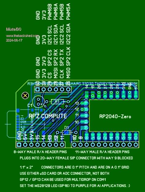

This is breadboard (and stripboard) friendly. It only needs a 20-way female SIP socket to plug it into. If you block way 9 you can easily see if it's in backwards.
I think it's pretty self-explanatory. It's obviously intended as an embedded control module, but it's easy to reprogram and move around. It could be mounted horizontally, and fastened down with the fixing hole, but it's probably a bit of a waste. Cheap to build and every (normal) pin of the Zero (which is surface mounted) is made available.
Once again, I'll produce gerbers if anyone is interested.
Edited 2024-06-17 08:03 by Mixtel90

Posts: 9081
Posted: 10:17am 18 Jun 2024
I've just been wondering...
GP28 and GP29 can also be COM1, which would make that connector nice for adding a RS485 module onto. However, it clashes with GP12 and GP13 being used for multi-drop. Maybe I should move multi-drop onto GP8 and GP9 (COM2), but it's a bit awkward.
I'm just playing with a little "PLC" motherboard design idea, using three of these as a master and two slaves. :)

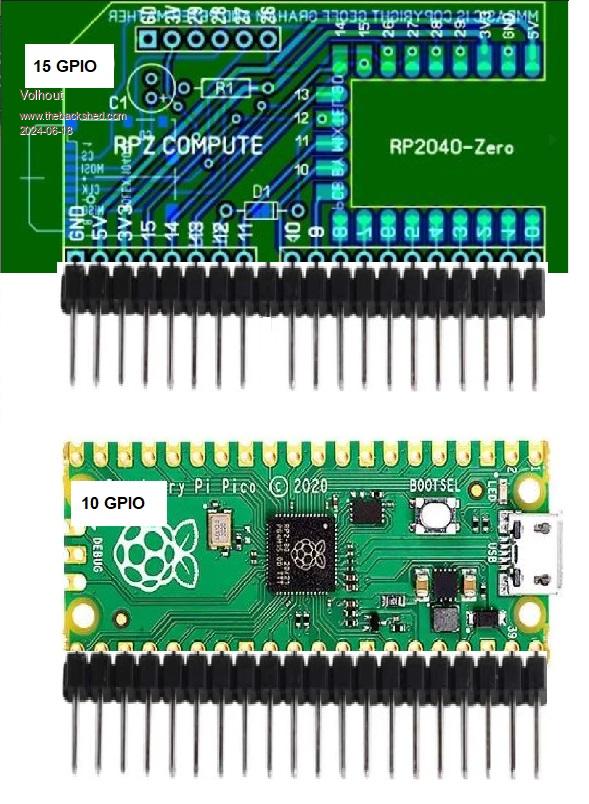

Posts: 6050
Posted: 10:39am 18 Jun 2024
Low cost compute module....
No SD card though...

Posts: 9081
Posted: 10:44am 18 Jun 2024
Mine's more fun - and has USB-C and provision for COM port multi-drop. It also has a WS2812B and reset button. :)
And the RP2040-Zero is cheaper, although you have the PCB cost.

Posts: 6050
Posted: 01:21pm 18 Jun 2024
Hi MIck,
Yes, the zero is cheaper, just ordered 5 of them for 1 euro 80 each.
But it is also 2Mb. No larger A:/
Edited 2024-06-18 23:30 by Volhout

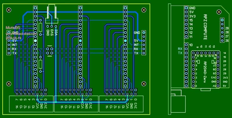

Here's my idea for a simple multi-processor controller using the RPZ compute module.
Is it the cheapest expandable PLC? :)
The LH socket can be configured for a normal expansion module or for the master. There can only be one master on the system and it has to be the leftmost one. The board carrying the master has the two resistors fitted and the four pads linked as a crossover. There is no expansion to the LHS for this board. Expansion boards don't have the resistors and the pads are linked straight across.
Each module is powered from the 5V rail and provides its own 3V3 for its IO. A VCC pin allows an external supply to be available to the outputs. It could be used to power, say, more powerful LEDs than the IO pins can supply. It's separate from the 5V rail as it could be 12V for example. Each board has its own VCC. You could run one at 12V and another at 24V if you wish. :)  The 5V supply is common to all the modules so any of them, or the rear connector, can be used for the supply.
IO connections are via horizontal IDC connectors.
There is a common INT line on GP15 with a pullup resistor. This is intended to be an interrupt or reset signal line - it depends on the application.
Posts: 6050
Posted: 07:35am 19 Jun 2024
Mick,
Maybe a stupid question, but why did you put the multidrop components on the compute modules? You could have placed them on the cheapest expandable PLC board. In that case you would only need one pull-up. For speed yo would want 2k on there. With 10 modules, there is 200ohm pullup when the pullups are on the compute module. Logic levels (in combination with diodes) will be hard to meet.
Edited 2024-06-19 17:36 by Volhout
Posts: 6050

Posts: 9081
Posted: 08:02am 19 Jun 2024
There is only one pullup, on the main board - the modules only have an isolation diode on the TX pin. Putting it on there makes the main board layout easier, I think. Normally it is linked out by a solder blob pad so that the module can be used stand-alone and it becomes a normal GPIO pin. My intention is to specify a Schottky for that diode, which should help with the logic levels a lot. Small ones are cheap. As only one transmitter will go low at once the pullup could probably be reasonable - say 2k2 or 4k7.
Similarly for the INT line, which is intended to function as an open collector signal. You pull it low by using SETPIN to make it an output and release it high by making it an input. There is only one pullup again.
Ah.... Is this today's microVGA PCB challenge, Harm?  :)
It could have USB if you can double the PCB area. lol

Posts: 9081
Posted: 08:29pm 24 Jun 2024

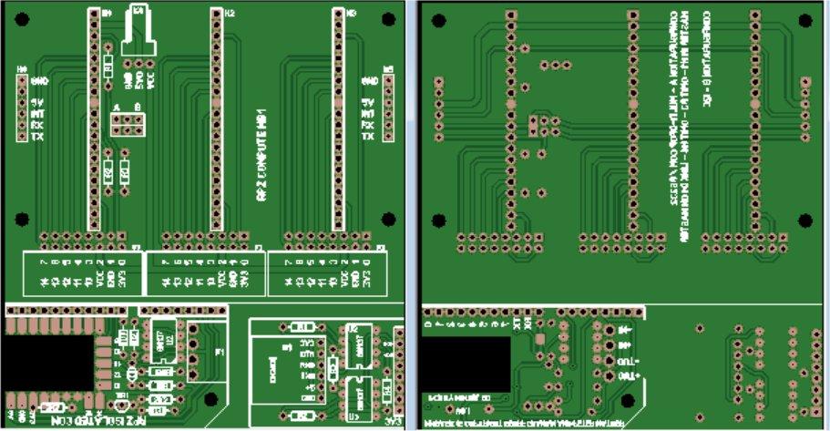

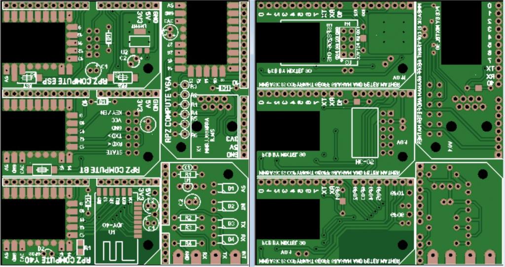

I have three new designs in the same format as the RPZ Compute.
RPZ COMPUTE VGA
Has a RP2040-Zero with a VGA output. Due to shortage of PCB area this uses a RJ45 socket. This works well over reasonable distances and RJ45-VGA adapters are readily available. You only need one for the monitor end. The ADC connector and GP12-GP15 are omitted. GP11 is connected to the INT signal.
RPZ COMPUTE BT
Has a RP2040-Zero with a HC-05 Bluetooth module connected to COM1. The ADC connector and GP11-GP14 are omitted. GP15 is connected to the INT signal.
RPZ COMPUTE Y40
Has a RP2040-Zero and a JDY-40 connected to COM1. GP08 of the JDY-40 is brought out to an on-board LED.  The ADC connector and GP11-GP14 are omitted. GP15 is connected to the INT signal. The JDY-40 is becoming a bit harder to find now, but there must be more than me that have a couple in a box somewhere. :) Handy for simply linking two motherboards wirelessly and cheaply. Very low current drain.
Additionally, I've been playing with the original module and it's now V2.2.
The GP14 pin can now be either GP14 (default) or GP26 selectable via LK2
The GP15 pin can now be either GP15 (default) or GP27 selectable via LK3
This is useful if the uSD card isn't fitted as it allows a couple of ADC inputs.
A slight tweak (adding a resistor position on the motherboard) now allows I2C to be used as an alternative to multidrop COM between the modules.
I considered doing a RS485 module but it's not worth it. A cheap converter has full protection and decent voltage handling.
