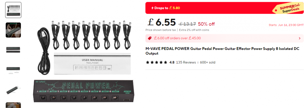

Don't know if this is of any interest. I purchased for intended purpose.

One has to ask why you would want to get it from 5V, since USB-C is quite capable of providing 9V (and a lot higher) if you use a suitable fast charge power supply and the correct lead with it. :)

the 9v would be low current

Only up to about 5A if you get it directly from USB-C Power Delivery mode. :)
Ordinary USB-C is rated up to 3A.
The limitation here is that the 5V will have to go through a boost converter to get to 9V. That will just about double the output current as drawn from the 5V, i.e. you'll need about 1A at 5V to get 500mA at 9V.

i'd be interested in seeing what is inside; if there are 8x little 1w isolating modules, or a couple of transistors driving a single transformer with eight separate secondaries.

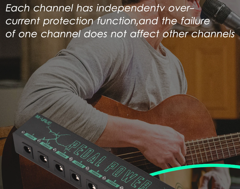

Oh sure but this is not a commercial venture. If others like the idea, I want them to be able to source off-the-shelf.
They claim that each port is protected/isolated. They actually state that a shorted port won't affect the others. I'll pull the lid when I receive it (well, them).

Good idea. Possibly a little polyfuse for each one.

Looking at the size of this box, I think there might be an isolation between USB and the 9V outputs, but not every output is isolated from the other, like some professional power distrubutors do. This still allows for ground loops.
Some guitar pedals arevery sensitive for ground loops.

the latest image shows writing indicating a maximum of 100mA per port. aside from cost, this could be achieved with eight of these B0509S DC-DC isolated converter modules:
https://www.ebay.com/itm/134739796524
i bought ten of these (except 5v out, B0505S) a while back with a view to using them to simultaneously charge individual Li-Ion cells in a battery pack without need for any balancing, but as yet haven't completed the project.

Looks like a nice box.
  Quote  Feature:
■ 8 Isolated DC Output
■ 8 LED lights are used for lighting indication in dark environment
■ Independent short-circuit protection, when one output is short-circuited, other outputs can still work
■Power input: Type-C 5V 2A
■Power output: 6 ways DC 9V 100mA, 2 ways DC 9V 300mA
■Low noise fully Isolated output DC power supply provides stable and clean power to your equipment to ensure that your effector works perfectly and produces the best effect sound
