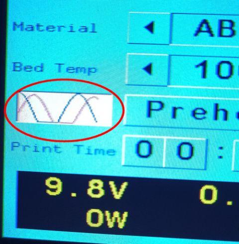

I wrote a tiddly cartesian graphics pack a while ago (it's on FotS), but one aspect that I felt was always missing was a graphics window with scaling and proper boundaries (so you can't draw outside of the window)
I got a suitable dev system up and runnng at last and I have been busy, see the tiddly graphic window on the screen below.
The new ORIGIN command sets the X,Y position (0,0 can be anywhere on the screen), sets seperate scaling factors for both X & Y axis (so you can have a window a million pixels wide and still draw sensibly in it) and sets the boundaries for the window so it can occupy any portion of the screen... e.g. you could have a window at Native position 120,130 with it's 0,0 centred and scaled so the X axis was -273 to +100 and plot those coordinates in it without the sytem "cropping" the position of pixels/line you set... oh and the window could be just 20 pixels wide if you like.
A picture paints a thousand words so an example of what I mean is below and shows the temperature/power curves (with dummy data) on my 3D printer heated bed controller: the drawable window is 80 X 30 pixels, but the X is scaled (in that 80 pixels) to show 400 points and the Y for 0 to 130. Note how the negative values do not plot out of the window and proportion is maintained.

it doesn't make any association with data, it's a scaled bit of graph paper - what you draw on it is down to you so you'd still have to manage your data in an array or something and plot/draw the data points, which isn't hard really. For this demo, I have an array of 2x70 integers. You'd would just have your array big enough to hold what you want. If you want to compress the data I have a logger routine which packs 2-byte words into a single integer if that helps.
In that screen grab, the little white rectangle reresents 0-130 on the Y (0-130C and 0-130W... convenient as my build plate has a 122W heater with a mximum heat of 110C)  and 0-400 on the X even though it is only 30 pixels high and 70 wide. But I don't have to take the physical dimensions into account when I draw my lines.
In the native graphics, if I did LINE 0,0 - 319,239 I get a line from the top left to bottom right, drawing all over anything else on the screen. Doing the same in the cartesian GFX pack; MOVE 0,0: DRAW 319,239  I would get a line from the bottom left of the white rectangle going off into nowhere about half way along (because 239 is beyond the boundary of the graphics window), but it would not corrupt anything else on the screen.
With the scaling, I could literally have the window 86400 "pixels" wide which provides plot points for every second in a day, all in a space 70 "real" pixels wide. Of course there is a loss of granularity, but it works really great for a quick look at trends etc. and you can still do 1:1 scaling if you just want the graphic sindow with boundaries.
In the pic above, there is no real detail in the graph (coz it is miniscule), but I can easily see what the temperature and power curves look like. The measurements are seperately output to the console so I can scrape that and put it into something like Excel if i need to analyze the real stuff.
As for managng the data, I have an array where I store coordinates (so I don't do the scaling every time I need to re-draw the line) and I scroll it left as the diagram extends by clearing the window and re-drawing (which is surprisingly fast even on little mites)

The GFX pack is all MMBasic and underneath are the normal MMBasic drawing primitives (LINE, PIXEL etc), no CSUBS or anything.
the only requirements are the code (tiny) and a few global variables
I see no reason it shouldn't work on any device with a graphics display. I am developing it on a MicroMite eXtreme with VGA display, but the first "real" target will be a Mk2 with ILI9341 - hence the Heated Bed Controller software in the pix/vid

I have a few variables defined but you can work that out. Note I store pixel positions (not the actual data) in Graph() - this means I don't have to scale when I draw the line as a whole (when scrolling) - the array already contains what I need and it speeds thing up for the display - if you are going to want that raw data, make arrangements to keep it... It also uses the cartesian GFX pack and my version of the Map() function. This deceptively powerful function is responsible for the scaling. Map takes a value in a given linear range and returns the proportional counterpart in another range - so I could say I have a value 0-86399, return me that counterpart in the range of 0-69. e.g. supposing my value is 21600 (25% through a day)
> Print Map(21600,0,86399,0,69)
17.25019966
so 17.2 is a quarter of the way to 69, in the same way 21600 is a quarter of the way to 86399 - it is the "proportional counterpart" in the range. Besides doing this, Map() also constrains the data to the ranges, so it is also responsible for enforcing the window boundaries - all in one small function.
I have used it for so many things
When I have it all working, the MAP will be handled in the new GFX pack, but I give it here so you get the idea of how the scaling works
