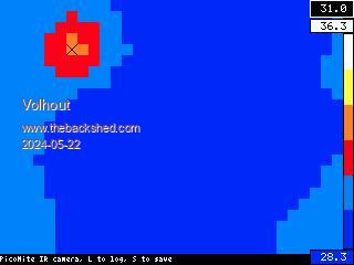

This thread is about a Thermal Camera based on PicoMite and a MLX90641 camera module that can be purchased around 20 dollar at Digikey or the likes.
The proto is running on VGA, but will have to be tested for a while before I release the code. The final product will run on LCD (handheld). The idea is to create a plug in for the Game*Mite expansion connector.
So this is just a heads up of what is coming, using the limited color palette of the VGA Picomite. The camera is 16x12 pixels, and this has been upscaled to 31x23 pixels.
The screen refresh rate is 0.5 seconds.

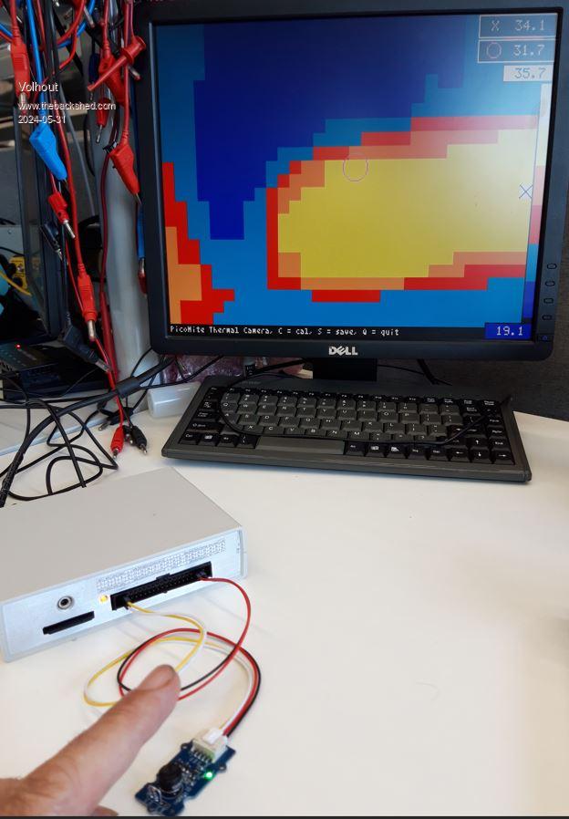

I use a Seedstudio Grove IR camera module with MLX90641 with 110 degrees opening angle. Final design will use the 60 degrees opening angle part (software compatible).

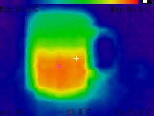

The current code upscales a 16x12 array to 31x23 by simply calculating the pixels in between in MMBasic by linear interpolation. Since there are only 16 colors in the VGA and in the framebuffer (needed to get speed to the LCD updates mainly) this gives a blocky screen. But it is the maximum that can be done in MMBasic in a refresh rate of 2Hz. Painting 700+ BOX'es and drawing the text etc..
If you see this (using probably the MLX90640 32x24 pixel array) and a piece of C code, you can start painting individual pixels.
demo code
The video is realy nice. Using all the colors, and calculating pixel RGB values using a fast algorithm, and immediately pushing the pixel out to the screen.
Still a lot can be improved in  MMBasic code, but I may need to work on a CSUB to do get closer to this demo.

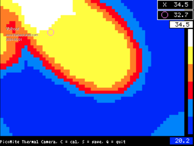

Experiment with 4x upscaling...
The calculation and plotting takes more time
2x upscaling : 190ms
4x upscaling : 730ms
So the total update rate goes to 1 second.

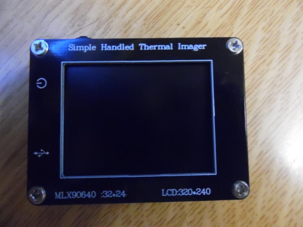

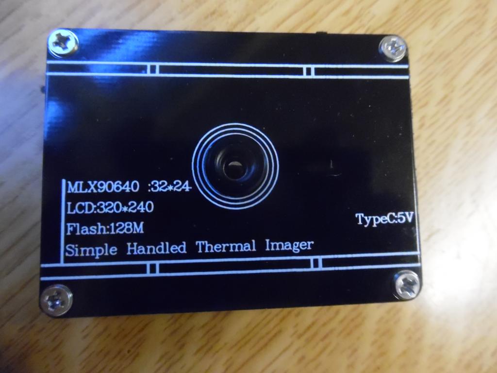

Posted: 07:47pm 31 May 2024
I went and bought a camera that looks like a kit for £26. no instructions. can't read as usb drive. could it be hacked for data ?
Posted: 09:20pm 31 May 2024
it could be a premade adafruit board with lcd and battery. figured usb and scroll through saved images.
