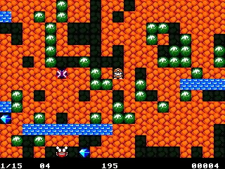

Here is the version with working routines for butterflies and fireflies. The zip file only has the basic program, so the folder structure and files from the first upload are needed. Now all that is missing is a proper framework( Menus , Gameover etc.) Then the enemies will also be set to deadly. GNR-Beta2.zip have Fun 'no comment |
