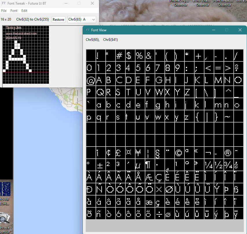

I have been playing with FontForge on another project and decided that it does a much better job of converting TTF to bitmaps than FontTweak.
I export the bitmaps from FontForge as a Microfoft style .fnt file and import into FontTweak.
There are a few steps but they are hopefully clear enough in the FontTweak help file.
The ZIP includes the exe and help file
FontTweak.zip

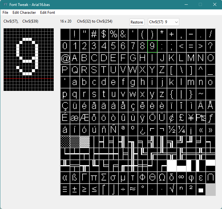

I have joined the font view and character view windows together. It makes life easier.
I just need a few days to finish the Linux version before releasing the update.

Hi, Jim,
If this is latest FontTweak version, it has same problem earlier versions had too.
When creating new font , I leave chr 32 empty, then add chr33 , then add chr34 and chr33 is cleared, add 35 etc - chr34 will be OK. chr33 will be cleared again... and so on.
In summary: on every new chr added, chr33 will be cleared.

The code for adding to a new font has a few problems.
I have fixed some but need to do more testing then I will post an update.
Going forward, I intend to include FontTweak in the MMEdit distribution.

I find FontTweak very useful, and occasionally frustrating. Sometimes a character I've been editing just vanishes and I have to start over. I haven't yet figured out exactly what event sequence I'm messing up.
I've started using FontTweak in conjunction with Paint.NET. I draw my images/characters/text/whatever using the paint tools (use black and white, with anti-aliasing turned off.) I use a large canvas so I can see all elements at the same time. Then I copy the exact size region to a separate canvas and save, to be imported as a character in FontTweak. If FontTweak could select a region of an image and not just scale the entire image, that would be most useful.
Often I use the tool for making custom graphics, resulting in large glyph sizes. Last night, I was creating 48 wide x 28 tall 'characters'. The combined font and character views is awkward because 16 characters wide gets shrunk too small to clearly see the characters, unless the overall window is super wide. (Maybe an 8 or even 4 wide option?)
